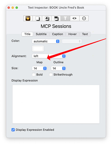

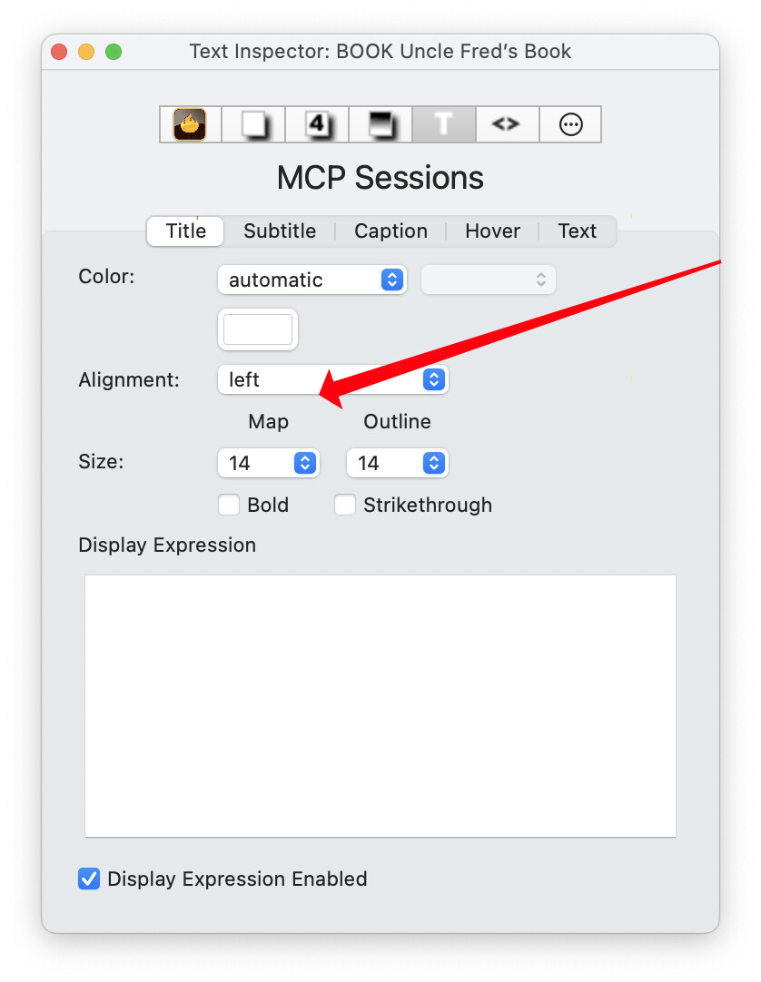

  • how to make note titles automatically centre in map view. I found the document settings option but that didn’t centre them (it centered the notes in the ‘side bar’) and I can’t see anything else that might work. Is it not possible to centre note titles in map view? Perhaps it’s possible by creating a prototype?
  • prototypes: I have created a note that I’d like to become a prototype; opened the inspector; went through each of the tabs but seem unable to find where/how to lock in the centered title and color (which is all I want). I did search the TbRef site map prototype section but wasn’t able to find what I’m trying to do.
Thanks again for responding.
Inspector: Title Inspector: Center
AAHHH!! Thank you!!
Just created a new note and it didn’t automatically centre.
So do I need to add this to my note prototype, so all new notes automoatically centre the text?
Yes. Under the hood you are setting the system (i.e. built-in’) attribute NameAlignment. The default for this in a new TBX document is left and allowed choices are left, center, or right.
The Appearance Inspector, as show 2 posts above, changes $NameAlignment in the selected note(s). As you suspect, if you’d like all notes using a prototype to have the same $NameAlignment value, you set a value of center in the prototype. As you’ve probably already set a value locally some notes using the prototype, you can use an agent to ‘reset’ the inheritance. Let’s assume the prototype is called ‘pTask’ (you can substitute your own name in the example code). Make an agent:

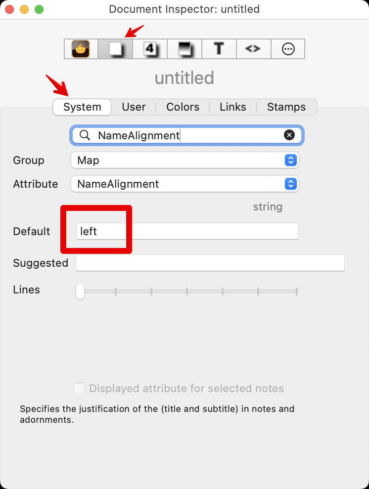

A separate case might be that you want all note in the TBX file to use the same, non-default, $NameAlignment value? For that we edit the attribute document level default in a different part of the Inspector, in the Document Inspector’s ‘system’ sub-tab. Open that Inspector and select the NameAlignment attribute to display its settings:
To make all (new) notes in the document use a centred title alignment, you’d set a value of center. Again, you might want to reset all local values of $NameAlignment (notes, prototypes notes) so inheritance of this is restored.

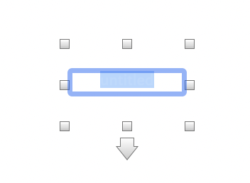

… except I made an error while trying to create a prototype that deleted all notes’ visibility (still have info in outline view). When I click around in a blank map area I accidentally find ‘shadows’ of previous Notes (image below), so I think/hope they might still be there.
Now in trying to make a new note, I get this… and when I click outside this, it diappears. In Inspector I tried re-instating a border but that didn’t solve it. I think the prototype that caused this is doing what I asked it to (I hit delete to cancel my last action, which deleted all my notes - I know why) but I can’t find that prototype to fix things… as it’s doing what I (accidentally) asked it to do (?). I did open Window>Prototype Inspector but that didn’t help me find it.
TIA
You likely made the default color of the prototype note “transparent”! :slight_smile:
If the last is the case how to fix? Try this agent…
Query: `$Color==”transparent”`
Action: `$Color=;`
Unless, of course you set the document default for $Color. In that case you’ll need to use the Document/system Inspector to set more useful default value
