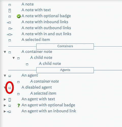

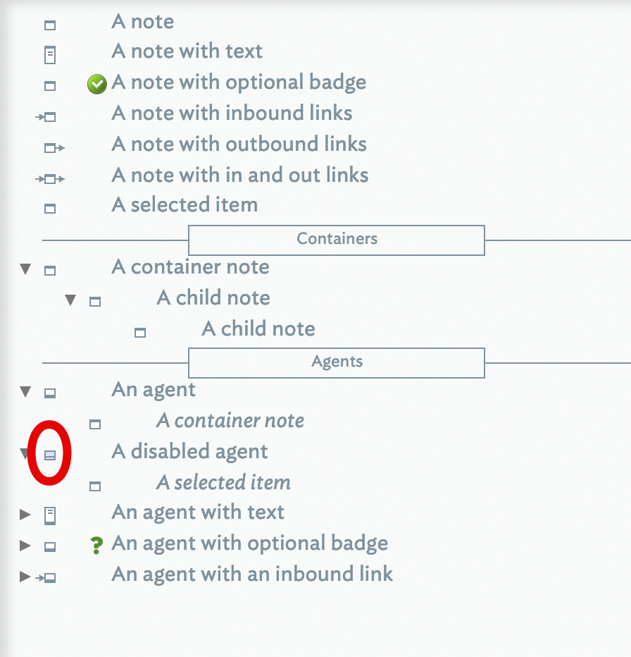

Icons and badges are summarised below:
Differences:
  • Only agents have the thick border at the bottom of the icon.
  • Little lines inside the icon indicate there is some $Text
  • If an optional badge is applied, it is shown between the icon and the note’s title text.
    • The space between the icon and the badge is reserved for the link-dragging widget. The latter is only shown when that item is selected in the view.
  • Links (not illustrated). If the item has 1 or more inbound links a short stuf arrow is drawn pointing inot the left side of the icon. The same, for outpbound links, has an out-pointing stub arrow on the right side of the icon.

One more outline icon variant you might see is an agent (thick bar at the bottom) where the thick bar is hollow. That indicates the object is an agent but that the agent is turned off at present (i.e. not running its query—though it still retains any alias present when turned off):
That would be helpful; my outline has no “Fat Title Bars.” Is it possible to add/create these? If so may I bother you for the atbref outline link (lacking terminology I don’t know what to search for…but I am willing to try Fat Title Bars).

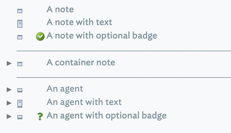

Unfortunately, these icons don’t alter with zoom but, look at these:
It should be apparent in the first (topmost) item that the top edge of the rectangle is thicker (‘fatter’) than the other three sides. This indicates that this object is a note (or container note).
For the second icon the thickest edge is at the bottom of the rectangle. This indicates that this object is an agent and not a normal or container note.
The third icon has no thick edge but has an small box the the bottom of the rectangle (in intent, an unfilled think line) indicating this is also an agent but in its ‘off’ state.

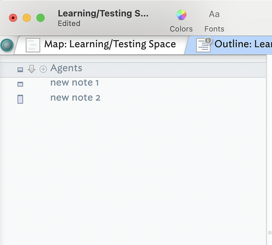

So the recipe to create ‘Fat Title Bars’ if I am understanding correctly is:
  1. in outline view > menu bar > Note > Create Agent
  2. this creates a new “line” (note) in outline view and brings the agent popover box into view… I’m not sure what to tell the popover … but I’ll move on with the recipe
  3. after creating this agent I will then tell it to go to turn ‘off’
  4. this will give me a ‘Fat Title Bar’
In the Note dropdown I also see the option to Create Separator. This is also helpful, although the ‘Fat Title Bars’ are more so.

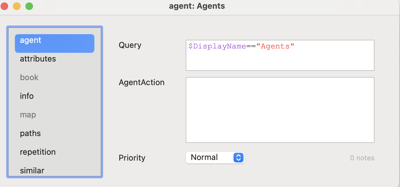

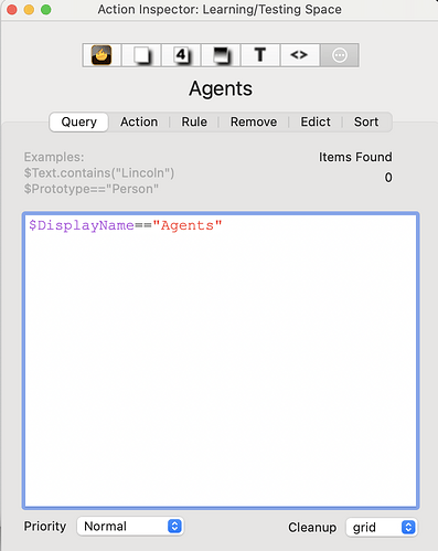

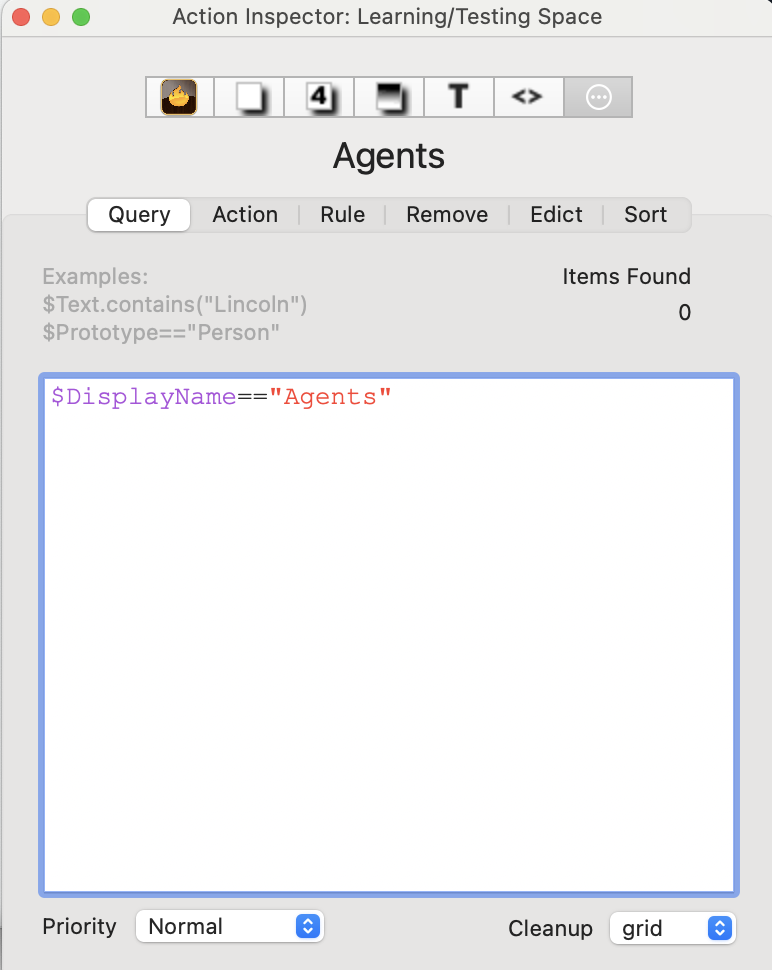

To create a FTB I need to know what to do with the agent popover box.
atbref says, “Agent title (only shown if the current object is an agent). The $DisplayName for the agent is […]”
I don’t find $DisplayName in the popover LHS options; I typed $DisplayName==“Agents”
in the top box:

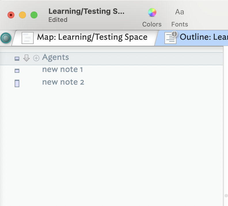

The agent appears (?) named in outline view…
… but it doesn’t look like your FTB; my assumption is that’s because I still need to complete step #3, turn it off. I don’t see anything in the dropdown menus about this; I go to the inspector and see this:
I can’t find a way in inspector to turn that agent off.

Your outline view showed what I am calling, for shorthand use in this discussion only, Fat Title Bars. The two in your image are ‘Containers’ and ‘Agents’. I understood you to be referring to them as you mentioned a thick bar; I now understand you are referring to the agent icon.
I thought this was about how to create “dividers” for my outline view that have the appearance of your ‘Containers’ and ‘Agents’ title bars/dividers that are ‘fat’ in the middle.
