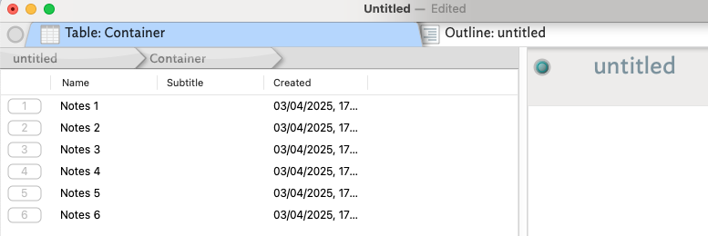

I think this could be a bug which I came across with my main working file and was able to reproduce with a simple demo. Consider the following simple set of notes
I switch to Table View (fantastic addition to TB by the way - I use it all the time)
So far so good. In Table View I create a new untitled note.
Unlike Map View untitled does not disappear after some seconds. Could be a feature… I don’t know. However, if I now delete the note “untitled” using CMD+D I get what I expect in Table View - the note is gone.

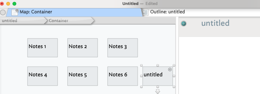

However, I now switch back to Map View and lo and behold there is a new note called “untitled”. It seems my deletion in Table View was not carried over or implemented.

Table View (ands Gaudí View as well) support two different ways to remove a note. Hide Note removes the note from the Table View by setting $TableHidden, but the note remains for use in other views. Delete Note deletes the note entirely. I believe The Delete key currently invokes Hide Note.
Automatic deletion of untitled notes is not yet adopted in Table View. It is a bit tricky to implement in Table View, since it’s essential to give users a chance to edit the note before sweeping it away.

I think I see the disconnect here. User assumptions != app design intent. No fault, but the disconnect has consequences.
I think the cause is that, like some other views such as Crosstabs, the view is a report rather than a fully consistent read/write view. Noted here:
In this view, the Delete (Backspace) key hides the selected row(s) rather than deleting them.
I suspect Edit ▸ Delete, like the above maps to Hide. Not a bug so much as a false signal and an unintentional UI/UX fail: menus should do what they say. If the user doesn’t know in advance that ‘Delete’ means ‘Hide’, hilarity ensues.
