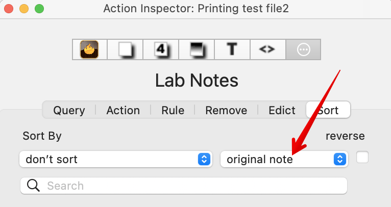

To make the demo work I added a prototype ‘LaNote’ so I could grab only lab notes and then I also filtered out those set not to export (for whatever reason). I applied a sort:
So the aliases listed by the agent are in the order their original notes appear in the outline.
Now you export, and you get one HTML file. You print that and you get discrete page(s) per note.
