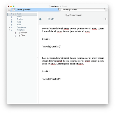

either I’m doing something wrong, or I’ve found a reproducible bug. The embedding of SVG graphics isn’t working properly.
Description:
If I embed two different SVG graphics into a note and then want to view this note in the preview, it doesn’t display two different graphics but instead shows the same graphic twice. It doesn’t matter whether I embed the graphics using ^include or copy them directly into the note—neither approach works.
The attached TBX illustrates the issue.
Does anyone have a solution, or is this indeed a bug?
S.M.
The following images illustrate the problem:

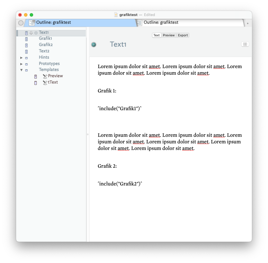

That is the note, including the graphics:

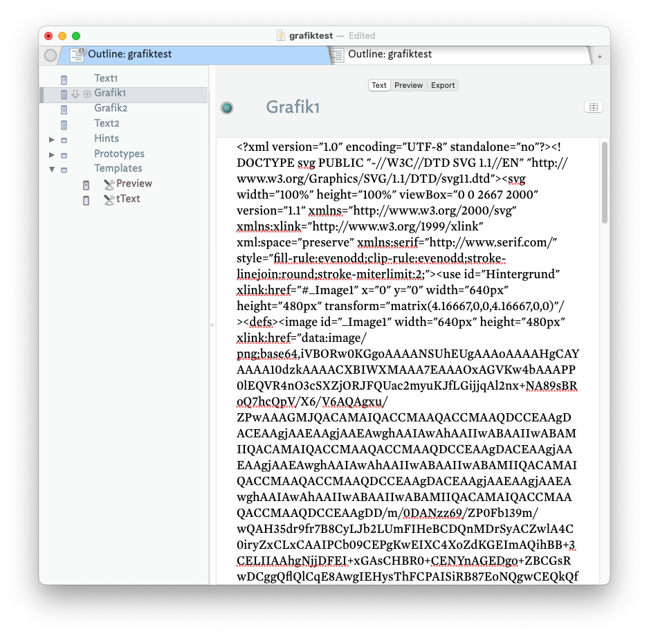

graphic 1:

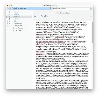

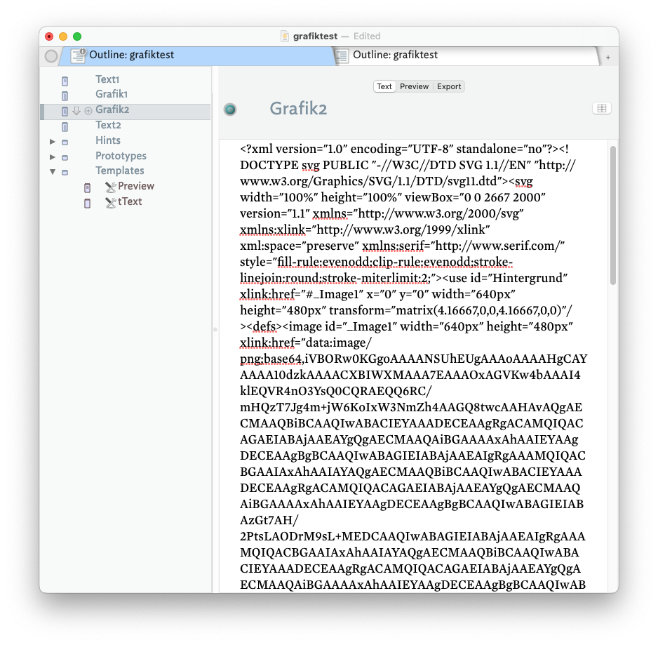

graphic 2:

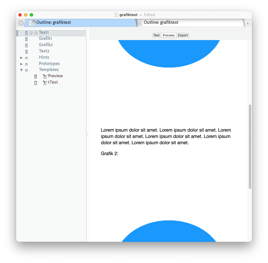

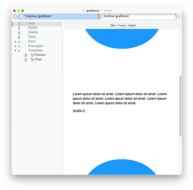

preview result: two time the same graphic (graphic 1), instead of two different graphics ( (graphic 1 and graphic 2):

I wondered at first glance why you were using so much code but I see it is because Tinderbox doesn’t natively support SVG images pages into $Text (I think you get a bitmap thumbnail but it doesn’t export). See Image formats for embedding.
So you are pasting the raw SVG code into $Text and using template ^text^ to render it. But you have given both SVGs the same ID that the HTML export adopts from the SVG. As the second image re-uses the first ID, the HTML is clever enough to know they are the same image and reuse the first set of image data.
If you change both occurrences of Image1 in the second image’s SVG to Image2 you get the expected result.
So the problem was incorrect SVG data.
