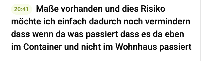

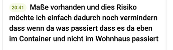

OK, so this element of the YouTube page’s transcript:
If selected, copied, and pasted into BBEdit shows:
untitled text 52 2026-03-20 16-38-20

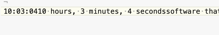

I’ve cropped some of the text, and I’m using BBEdit to show 'invisible characters like tabs, etc.

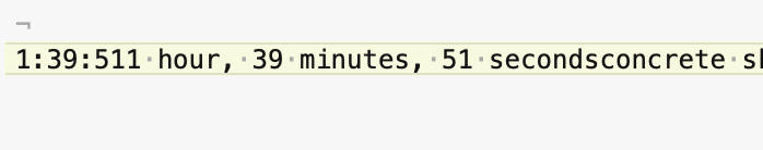

The next question is what is the format if the video is over an hour in duration A bit of hunting and I get this sample (from a 10 hour video!):slight_smile:
Actually, what is it like at time >9 hours:

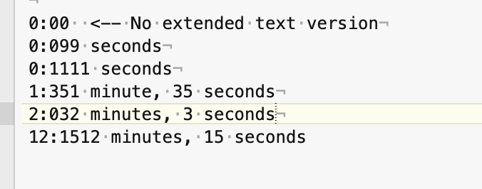

Gathering a few more samples, we see a pattern:

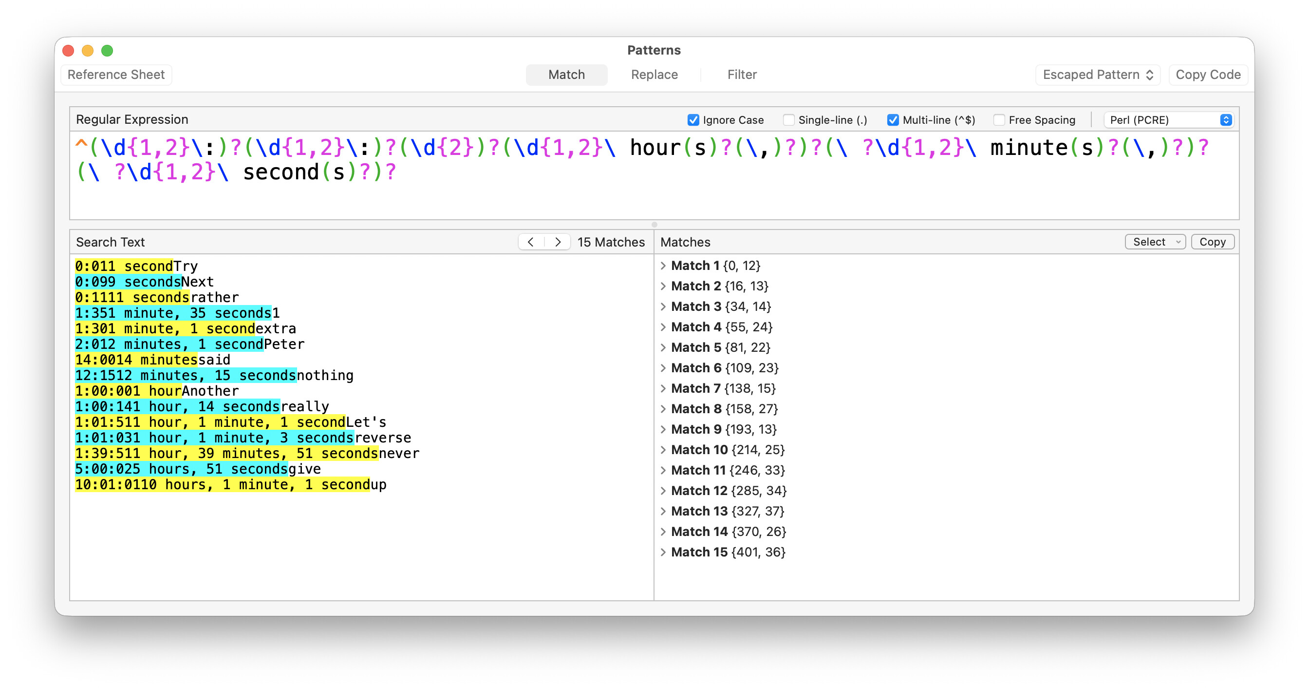

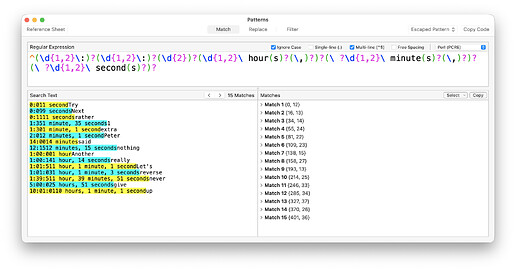

Testing in the Patterns app:
In the above the ^ is needed but for Tinderbox we need to remove it to get an action:
$Text(/Result) = $Text.replace("(\d{1,2}\:)?(\d{1,2}\:)?(\d{2})?(\d{1,2}\ hour(s)?(\,)?)?(\ ?\d{1,2}\ minute(s)?(\,)?)?(\ ?\d{1,2}\ second(s)?)?","");
