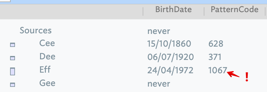

This is my current code’s results (note that I use dd/mm/yyyy dates), showing in test #3 that the pattern code has expanded to 4 characters:

The logic bug is where the year or month/day data may result in a two digit output. Thus in my earlier test we see 24/09/1972 (24 Sep) gives 1067 from the results 10, 6, and 7. This is because whilst a number over 9 like 15 will sum down to 6, 19 sums down to 10. So you need to look out for results, like 19, 28, 29, 37, 38, 39.
Of these I think only 19 and 28 will occur (year 1999 in your logic sums down to 28) and most likely in the year element only. I think the largest day+month initial sum is 29 Sep (29/9 → 20). So for initial split-and-sum outcomes If think you need to check for two special results: 19 and 28. You then need to decide how to resolve those to one digit. a starting point might be to use zero for both, until you hit on a better fix.
Also spotted a glitch (typo in code by me) in my demo file and 24 Sep 1972 returns ‘10102’ - so that’s an overflow on year and day+month count.
Whilst I can’t fully address the flaw in the underlying logic, this update assumes that sums returning a value that re-sums to a value over 9 (e.g. 19 → 10) are set to an output of zero (0).
