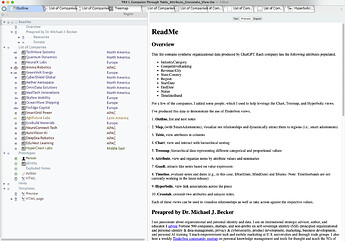

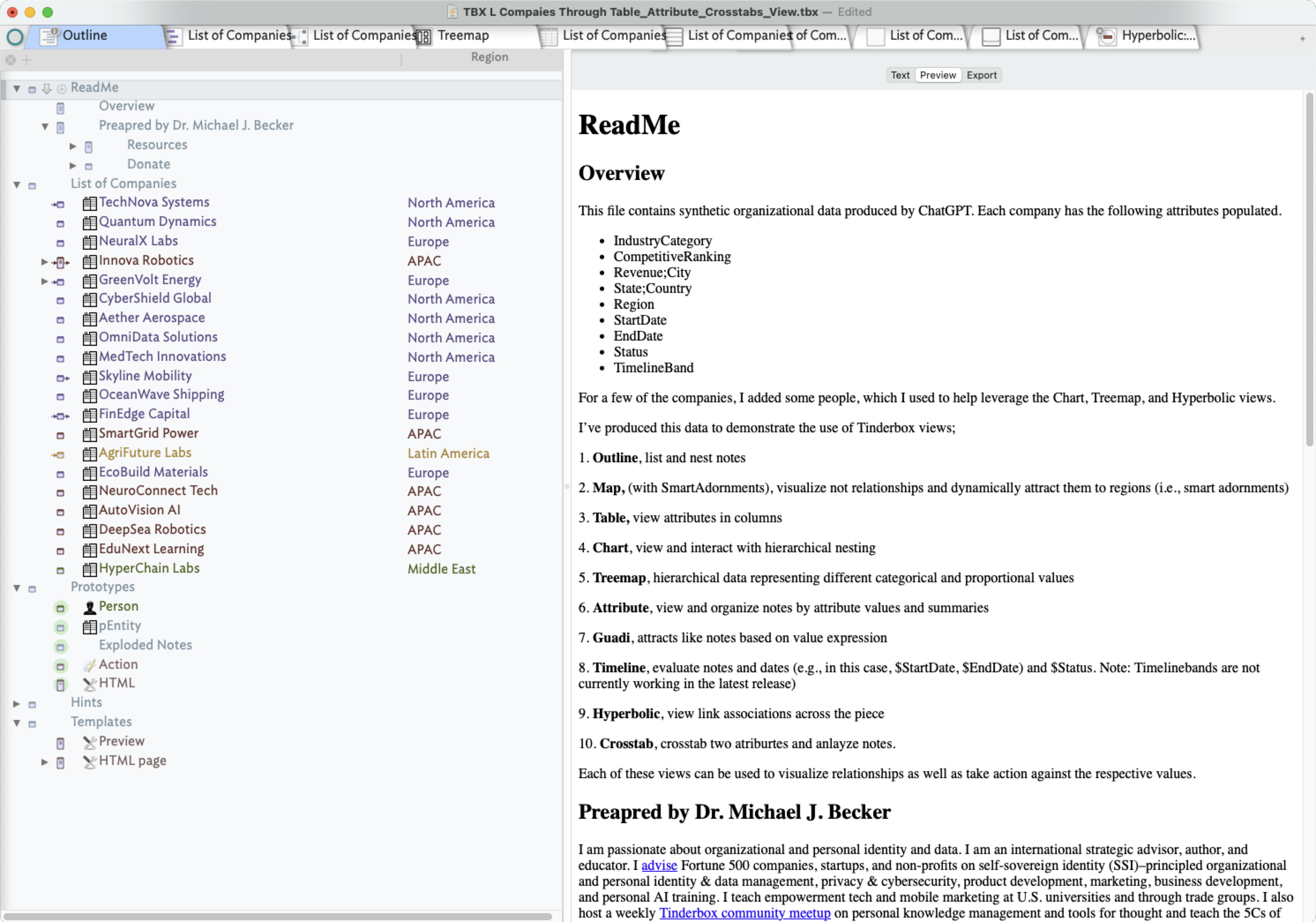

Take a look at this sample file. I created synthetic data (notes with populated attribute values) around companies and represented the data in all 10 Tindebox views. Hopefully, you and others will find this helpful.
5Cs TBX Comprehensive Tinderbox Views Overview R1 30JAN25.zip (56.8 KB)
(Version 3: Includes csv file in the zip. Also available here)
