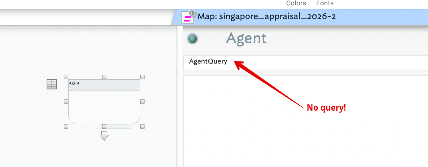

I created a simple Query to find all the noted that had $Accepted checked. However, try as I might, it the Agent is not running. $Accepted is Boolen. I have not made any spelling mistakes for the parameter for $AgentQuery. Priority is 5.
Where might I being going wrong? Thank you!

@mwra Thank you! Within “agent’ there is a note called 'Accepted’. It has the, AgentQuery: $Accepted
Thank you!

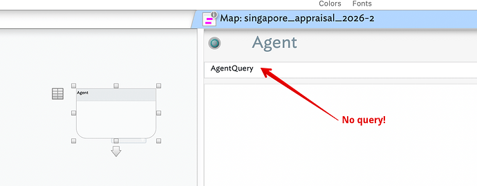

Also, in the last, the container is not an agent. Agents and notes are not interchangeable. I suspect you’ve assumed that giving a note [sic] an $AquentQuery is acts as an agent.
I suggest reading Chapter 10 of the Help ▸ Getting started with Tinderbox PDF, as it explains the basics of making your first working agent.

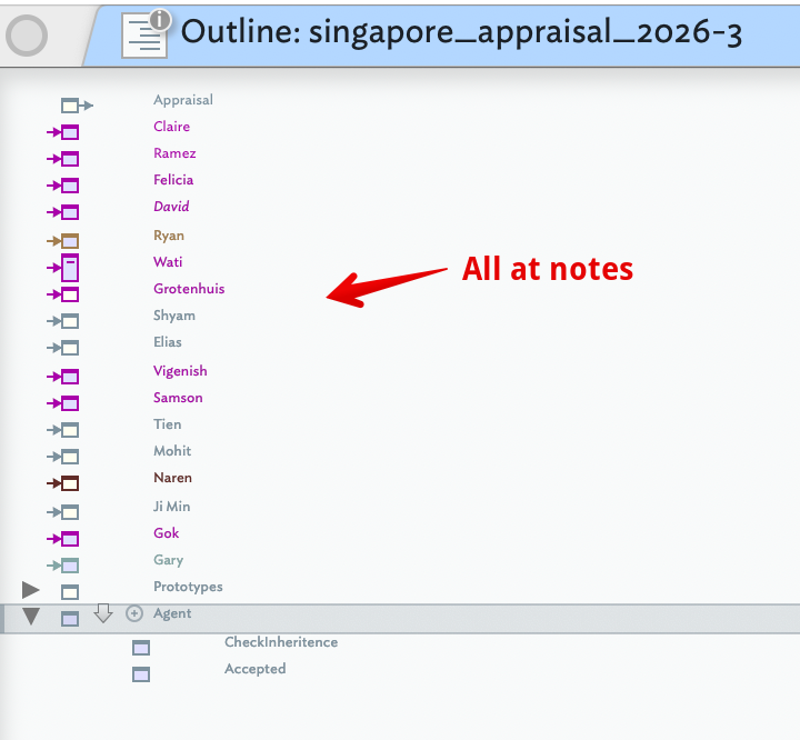

I checked the second upload you made and it has no agents:
How do I know? By looking at the note icons in outline view: see more.
In map view container are laid out differently, depending on whether they are note containers or agents.
