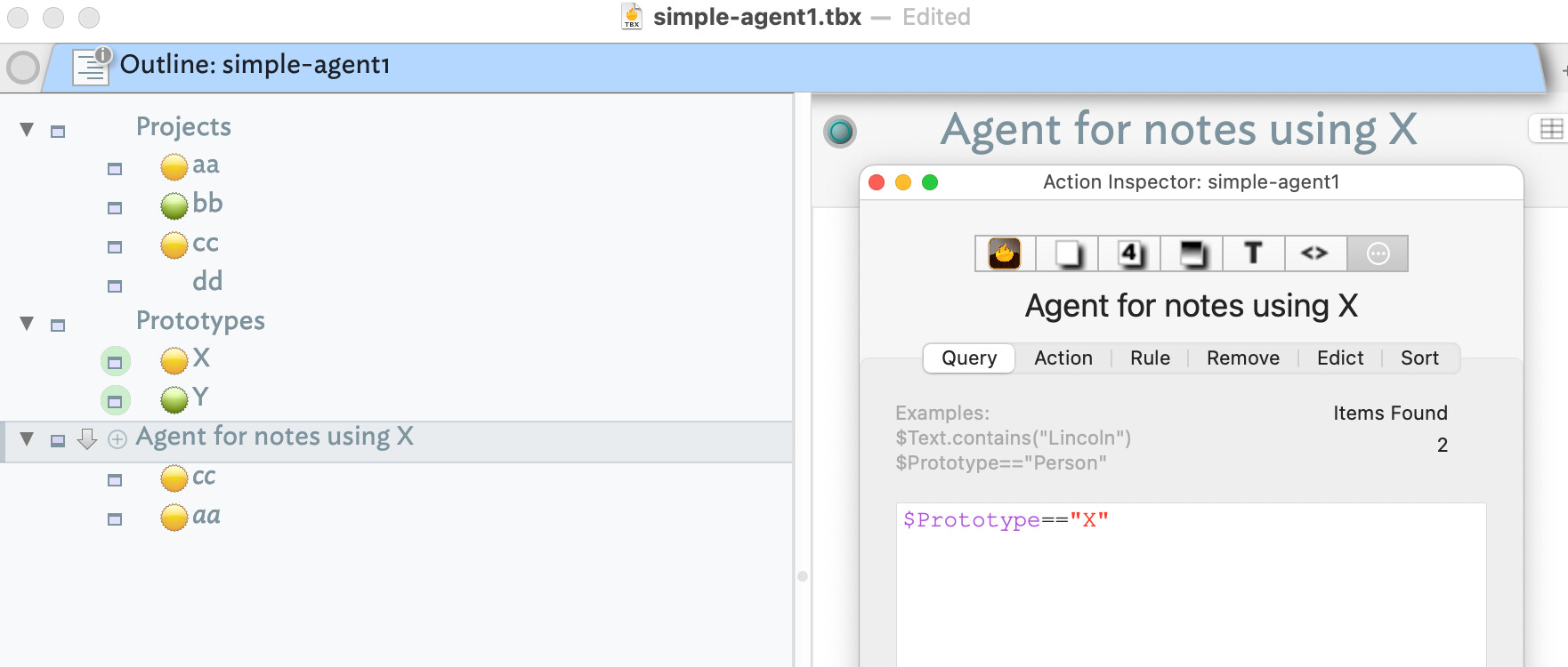

But, here is a very simple example of the above:
We have a container of projects, ‘aa’, ‘bb’, etc. WE have two user prototypes ‘X’ and ‘Y’. Here the only customisation is a badge. You can see the of the 4 projects, 2 use prototype ‘X’, 1 prototype ‘Y’ and one uses no prototype.
Now an agent, totally unconnected with any prototype uses the query:
$Prototype=="X"
to create an alias of any note (in the whole document) that uses the prototype ‘X’. As expected, it has just 2 aliases. They currently don’t sort in the same order as their original notes but that can easily be resolved by configuring the agent some more. The aim here is to the main idea.
Here is my test file: simple-agent1.tbx (131.0 KB)

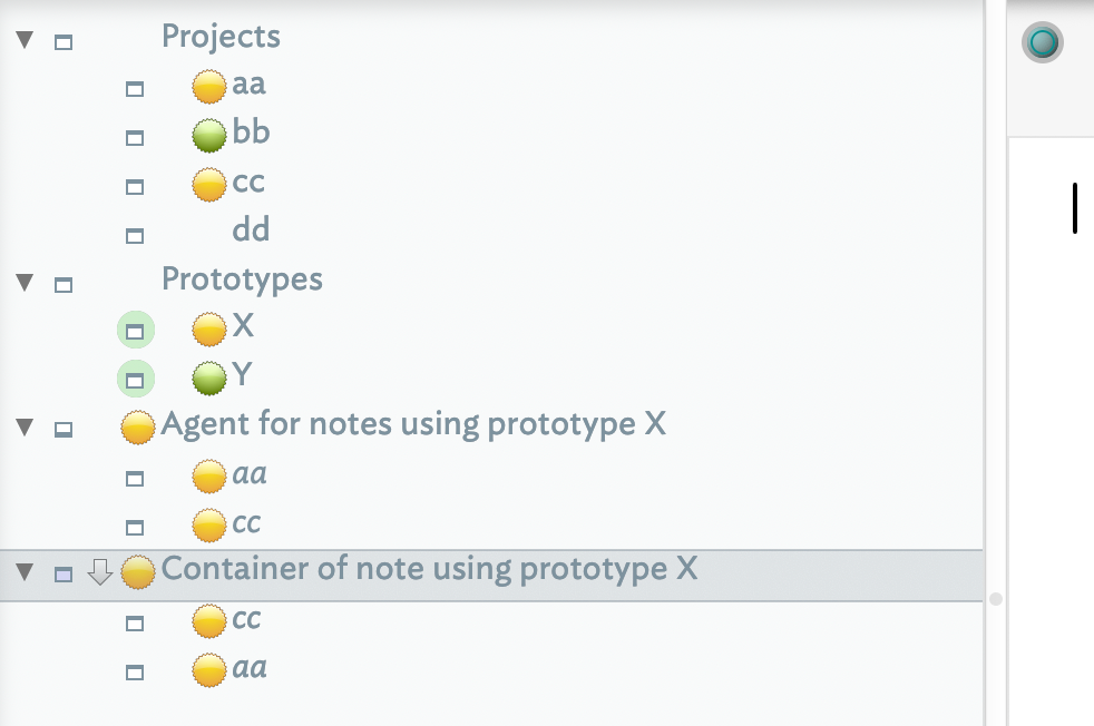

Building on my earlier demo, let’s assume the agent, which I’d here names “Agent for notes using prototype X”, copies all its aliases to a normal container—as you’d earlier asked. I’ve called that “Container of note using prototype X”. The result is like this:
Notice how the container contains exactly the same content as the agent. So why bother with the container.

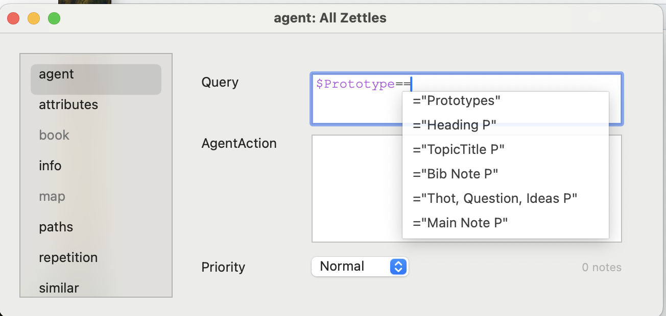

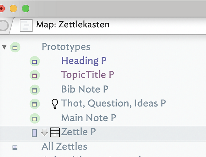

Attempting to follow your instructions; Zettle P is in my Outline View, but the agent Query box is not showing it as an option.
Zettle P is not currently marked as being a prototype. Notice that its icon lacks the mint-green halo that the other notes in Prototypes display.

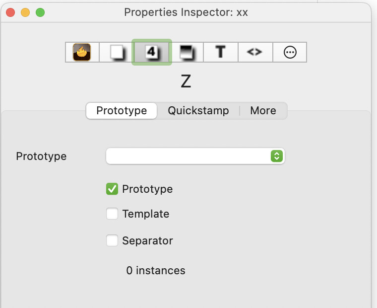

You can mark it as a prototype by setting $IsPrototype to true, or by checking Prototype in the Properties Inspector:
