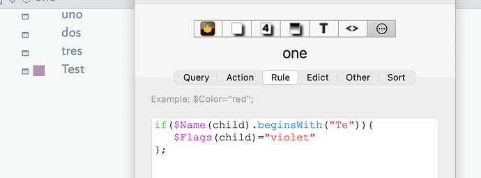

Stuck on rule syntax to change the attribute of a specific child note
Stuck on the correct syntax, here is a sample file for what I want… but cannot seem to make it work. I am missing something…..
I have a parent note with a rule, pseudocode: if the child note begins with “Te”, then color the $Flag = violet.
I cannot seem to make that happen. What am I missing? I think I might have used the child designator wrong but am not certain.

We know about the child designator:
child
The designator child represents the oldest child (note) of the note currently in focus, thus the first as listed in Outline view.
So for the container ‘one’ in your test, it keeps checking the first and only the first child ‘uno’ which fails the test.
You want to iteratively and independently check every child of ‘one’ and do your test. Try this:
collect(children, $ID).each(aChild){
   if($Name(aChild).beginsWith("Te")){
      $Flags(aChild)="orange";
   }else{
      $Flags(aChild)=;
