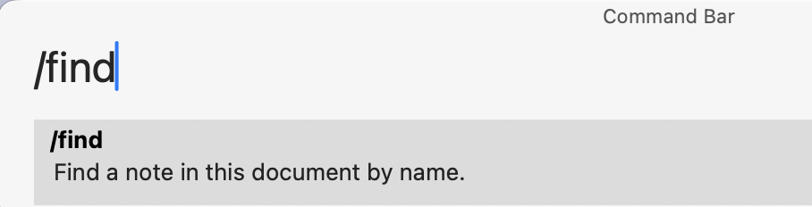

Understood. However, the Tinderbox v11.7 release page actually states:
* /find [searchString] will display notes that match searchString, using a fuzzy match algorithm.
N.B. “notes”. No mention of title ($Name) only. In-app I do see this:
I’ll check offline with @eastgate as to the design intent (in case there is a mismatch with current functionality) and update my notes as required.
I actually think ‘sources’ is mote pertinent as some things—such as aTbRef articles, thus outside the app—may simply
I’ll check and update as necessary.
/find in the command bar searches for notes by name. It adopts a permissive algorithm that finds near misses, and ranks those near misses. For example, a missing letter or word can be skipped and the note might still match. This can be very helpful for locating a half-remembered note, but is probably too permissive (and too slow) for extended text passages.
OK, I’ll clarify my aTbREf notes. Heh, it turns out the /find command wasn’t documented anyway: Command Bar.
