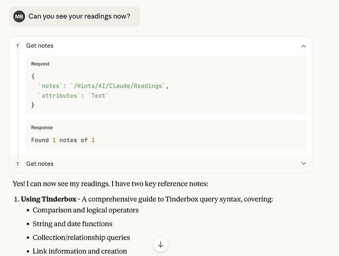

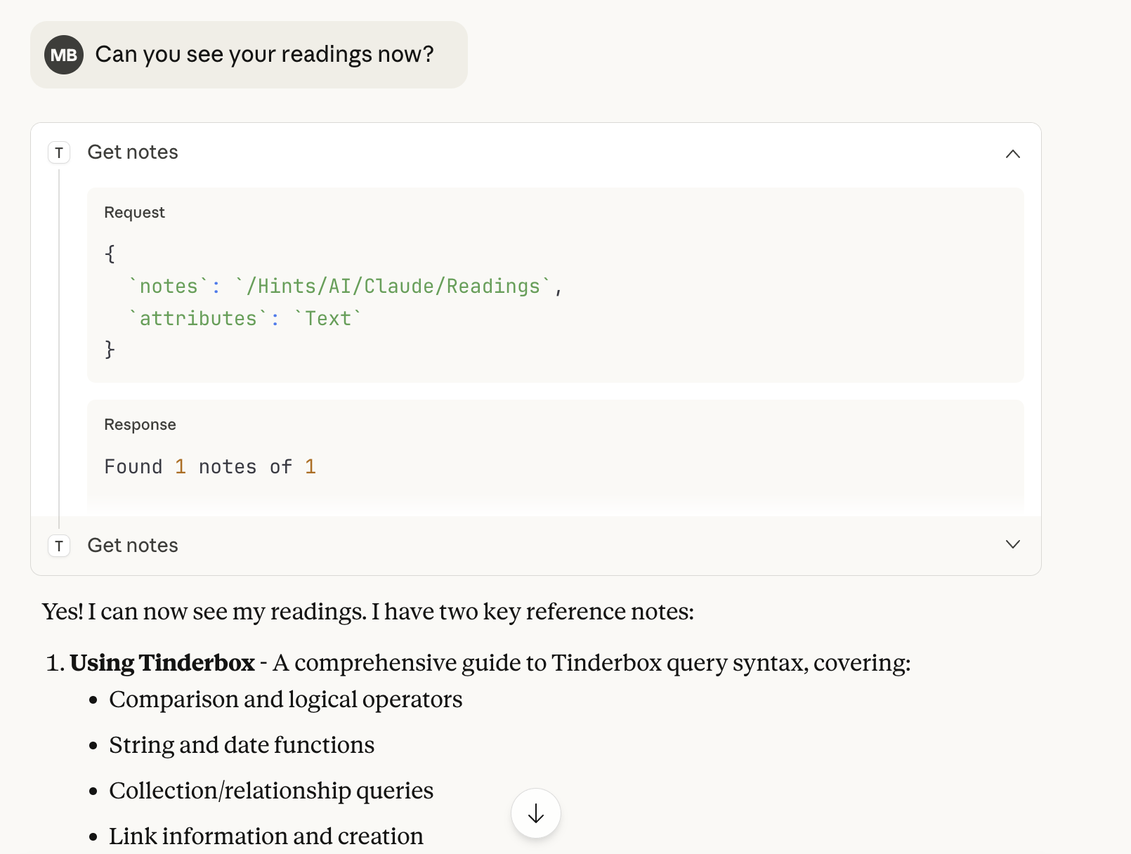

As above, it would help a lot to know what commands Claude sent to Tinderbox. Thereâs a subtle expansion triangle for each attempt to use a tool. For example:
Here, we can see that Claude began with the get_notes tool looking for the Readings container, and this was OK.

Taking it from the top: weâre very conservative about opening files. Claude cannot open documents; you have to open documents for Claude. So, the first thing Claude tries is to get the document Test AI.tbx. This didnât work (and hereâs a case where Tinderbox might have helped Claude out a bit with a more informative error message).
Next, weâre trying to check that the document has one untitled note. This suggests to me that it does not have a Hints container, and so Claude has not done its readings and has no idea (or not much) how to use Tinderbox! But never mind; Claude makes a reasonable stab at a query: $Name.contains("")
. Your untitled note is probably named âuntitledâ and so that wonât match. But I canât really fault either Tinderbox or Claude on this one.
The rest: I donât see the problem at first glance. Can you share the test document?

Here is the start of my chat: it seems to behave reasonably. Iâm using b740 which is newer than the current release, but I doubt that is a factor.
https://claude.ai/share/25a7be13-ef04-45aa-b0ec-b9638018d048
