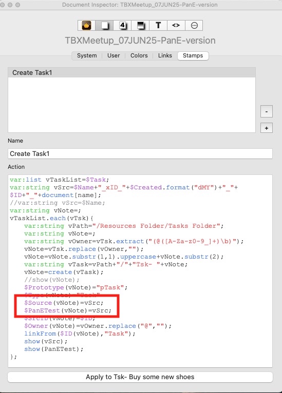

var:string vSrc=$Name+“xID”+$Created.format(“dMY”)+““+$ID+””+document[name]; => will not populate - HowTo debug?

A var: string is set, like this:
Then, further on, an attribute $Source(vNote)=vSrc; is populated with the above vSrc
This part, I could not get working.
  • Started over from scratch and still not working.
  • downloaded @satikusala’s demo file from the forum and started doing some comparing
  • still could not get it to work
Then:
  • I had already used show(vSrc) to have Tinderbox display vSrc => that worked allright
  • Then I added a user attribute and named it $PanETest(vNote)=vSrc; and added that to the displayed attributes as well, so in fact I have two identical attributes that are “named” differently.
And TaDa! that worked!!
But I still don’t know why the Source attribute will not populate…
Find my homework file attached.
Thanks for helping out!
Erwin
TBXMeetup_07JUN25-PanE-version.tbx (148.1 KB)
Oh, this was tricky to find!
On the line before $Source(vNote)=... — hidden in your screenshot above—is the line
	$Type(vNote)="Task"
Since the assignment to $Type isn’t terminated in a semicolon, what follows is ignored until we reach the next semicolon.
Wow! Thanks a ton!
My weary eyes couldn’t spot it!
Any (recommended) ways or methods you would suggest to get an easier grip on errors like these?
Here, once you’ve tried the $PanETest check there were really only two possibilities, neither very likely:
  1. Something crazy is happening which makes $Source unable to hold the result
  2. Something is interfering with parsing the statement.
My first guess was #1, which was incorrect. After that, I wondered whether there might be an invisible character or illegal character in that line. I stared at it for a while in BBEdit, and it hit me.
