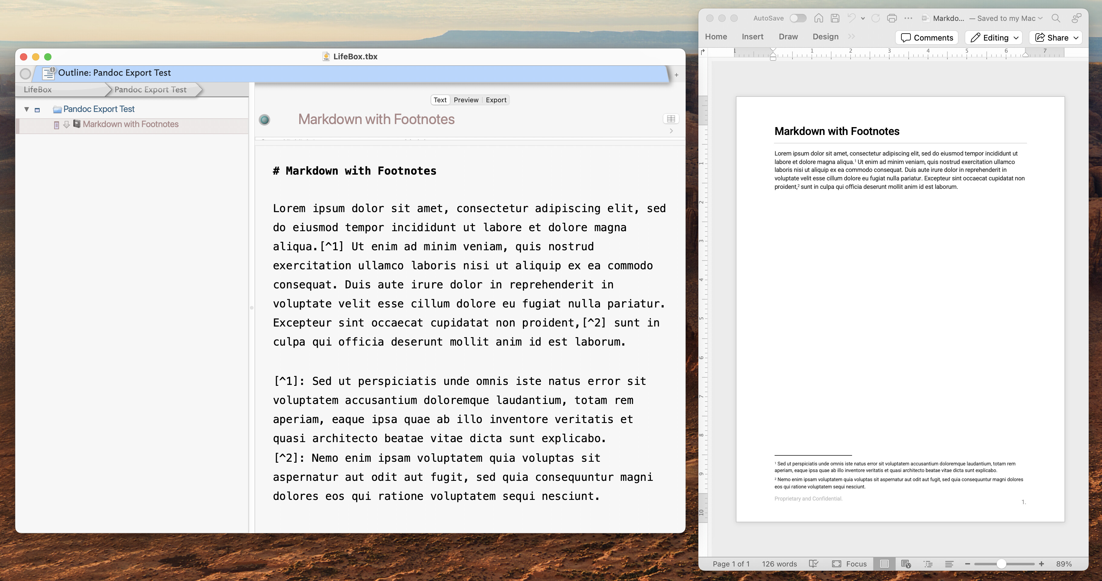

Using Pandoc and Markdown, one can create a document in MS Word with footnotes from Tinderbox. Here’s a screenshot of my Tinderbox → Pandoc → Word export workflow demonstrating how MultiMarkdown footnotes are rendered in Word:
If this workflow is of interest to anyone, I would be happy to record a demo and provide an example Tinderbox.
So if the target app were Mellel, I assume the process is:
  1. Write in Tinderbox using (CommonMark flavour?) Markdown to make footnotes.
  2. Export to Word doc from Tinderbox. Behind the curtain Tinderbox (→ Pandoc →) Word.
  3. Open word doc in Mellel.
IOW, once configured/tested, the Tinderbox export simply generates a Word DOCX, which the interim moving parts hidden from view.
That’s correct and this is how my export workflow works.
