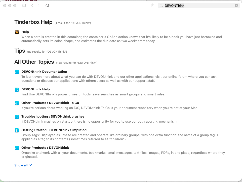

RTFM: The “Search Tinderbox Help” command was useless, as it only pointed me to the help file, not the specific location within it. I did ultimately find the section on “Watching Shared Notes,” but it didn’t answer the above questions.

I can’t see such a command. The Search box in the Help menu of macOS apps searched for matches in menus. The Search bar built into Apple app Help, i.e. into the ‘Tinderbox Help’ on the Help menu is known to be flaky. Apple seem to have no interest in assisting developers to make useful Help content. Still using the latter with the term ‘DEVONthink’ matches at least 7 articles.
Or you can use aTbRef †. Or, https://atbref.com/search.html will jump you straight to the search page for the current aTbRef baseline (v11 at time of writing). The search is a fuzzy search of title and full article text of the site.

Fully agree with you on Apple’s Help tool. While it isn’t Eastgate’s “fault,” it does contribute to the overall difficulty in finding the information I need.
Searching for DEVONThink on my system gave one response from Tinderbox and the rest from DT’s own documentation. That’s “7 articles,” but only one that I’d expect to be relevant to Tinderbox. Searching with the Tinderbox Help file open just kicked me back to the top level search.
