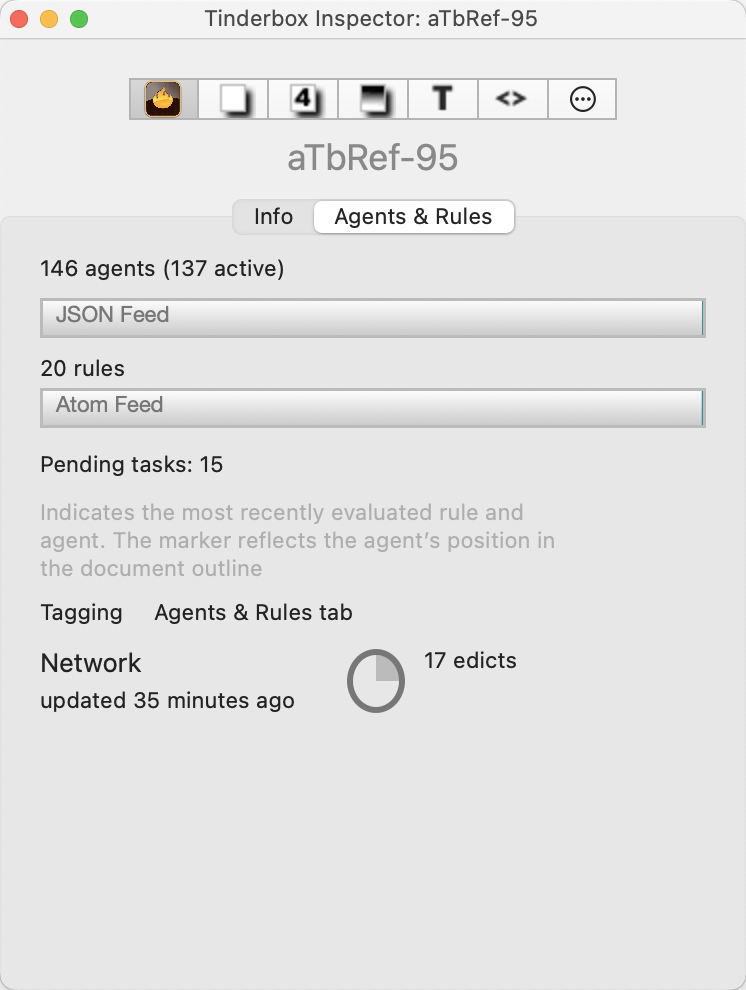

One thing to look at—and to avoid chasing what-ifs—is to look at the Agents & Rules tab of the Tinderbox Inspector:
If progress bar on the the agents or rules tell-back isn’t working or progress isn’t sent on the circular tellback at the bottom, it is a sign that something is amiss. If rules or agents stop at a particular point that rule (agent (or the one preceeding in in $OutlineOrder) merits a quick look. If the bottom cycle is jammed, something is having a very long thing. IOW, the edict not ‘running now’ is because its on athe end of a long queue of things wanting to ‘run now’. The edict can run until the queue for the run now queue drains.
