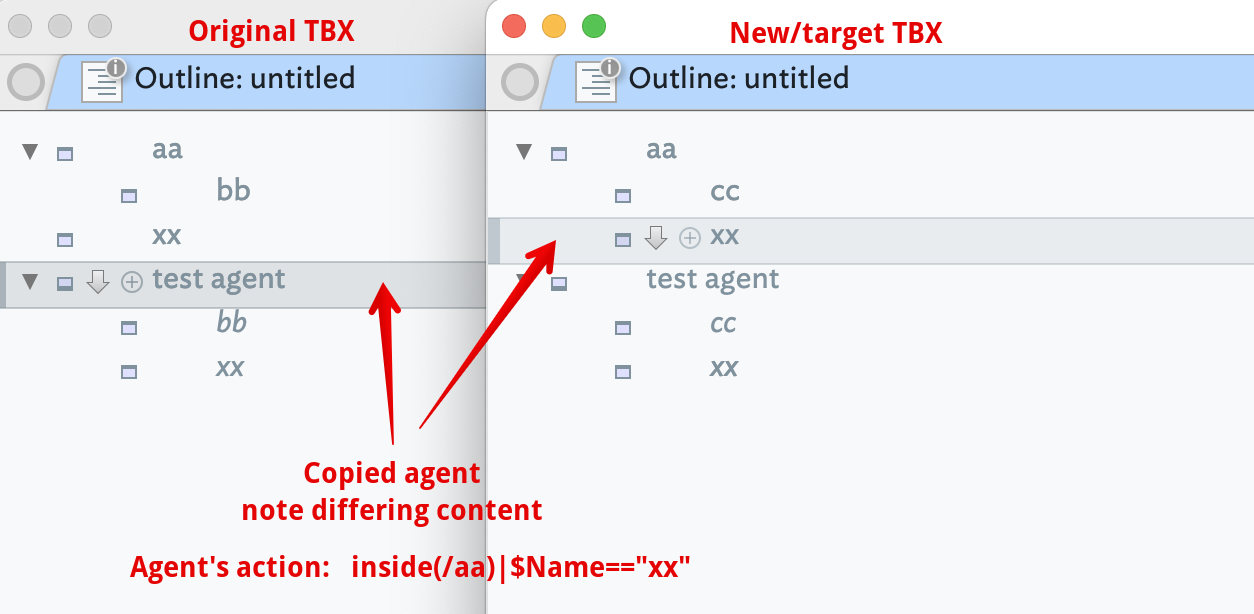

Agents can be copied at present, and work logically in terms of function in the target TBX. See this simple test:
The reason I mentioned agents is a predictable case where the user inuits (wrongly, as at v10.1.2) that pasting the agent will create a container note [sic], not an agent, and holding new originals based on the child aliases of the source agent.
