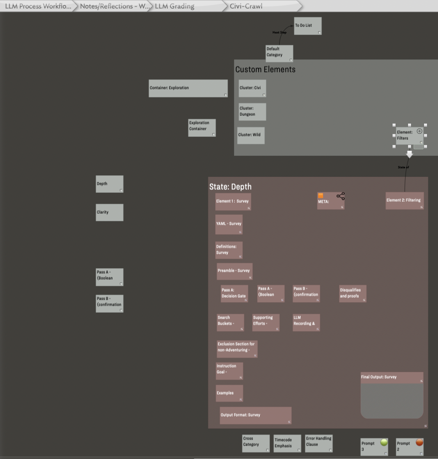

    In the above image you see my front panel for this work. Every adornment is going to end up with the final prompt, and each box within the adornment is a piece of the whole that needs special attention.

This is a picture of my dashboard were Im building prompts. As you can see I have the prompt divided into chunks on the adornment “State: Depth”
This lets me build the prompt out one chunk at a time, and lets me visually rearrange the flow of the prompt based on the needs of the LLM understanding. Ordering the text does make a big impact on the LLM understanding.
This is very helpful, but comes with downsides.
  1. Making changes to the code can be tricky as I have to hunt around for it by clicking on the notes and scrolling until I find it.
  2. The process of compiling all the notes into a final process is tedious, it’s clicking on a note, copy the text, output into another note one at a time to preserve the order.
I know there has to be ways to improve this workflow. Are there any obvious improvements you all see that will help me use this design to build long-context prompts?

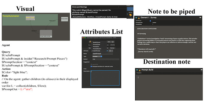

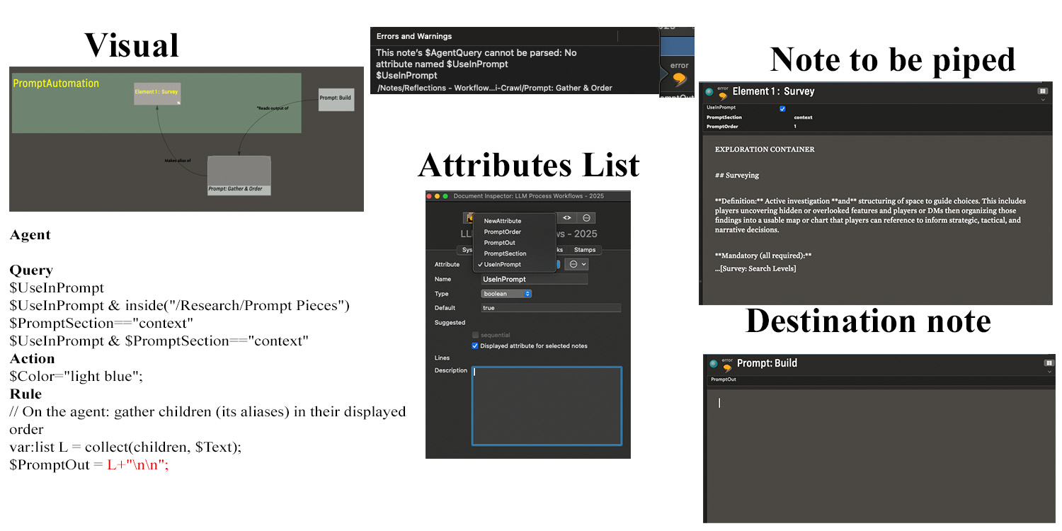

I followed @eastgate suggestion, had gpt step me through the process; Im almost there but Im not getting any output yet. Here is a picture of what I set up - not sure if it’s enough info.
Any suggestions?
What should be happening is
  1. (Visual layout for reference) - the note “Element 1: Survey” should be aliased by the agent and piped through the $PromptOut and the text recolored to light blue.
  2. The “Prompt: Build” should see the $PromptOut and print the light-blue text into the $text field
The green adornment “PromptAutomation” is stamping the notes dragged in with the attributes that the agent is looking for.
So as soon as a note gets dragged into the adornment, it should be detected by the agent and piped out in light blue.
Also, I dont understand the error as the $UseInPrompt attribute exists and though it does default to “false” I manually change it to true.
You have an error in your argument; you’re calling $ UserPrompt, but it does not exist.
It is not clear what you mean by “any ouput yet.” It is not clear where you want the output to go.
L.format is not correct; you’d use L+“\n\n”;
I can’t see the agent, so it is not clear what it is collecting.

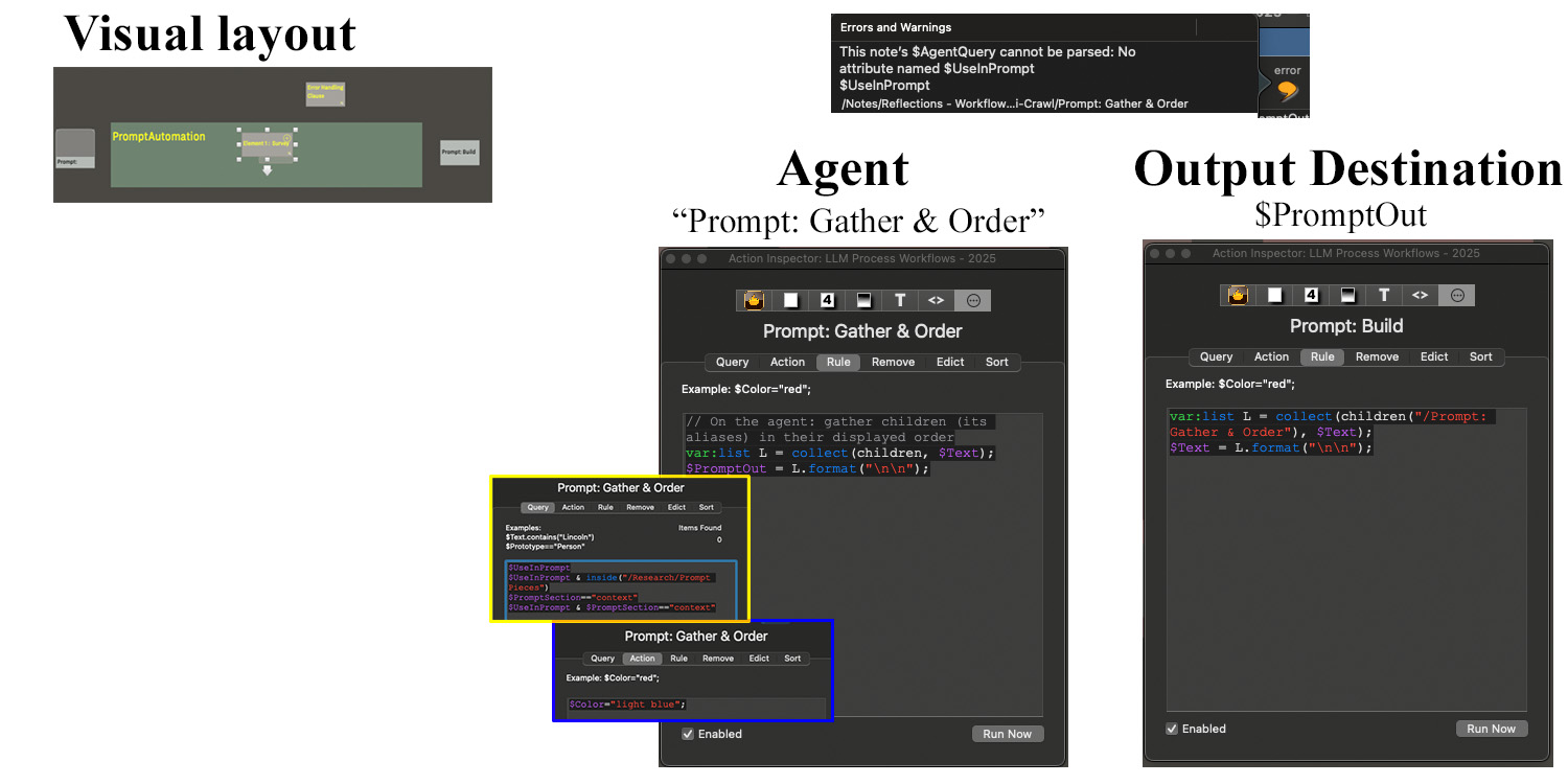

OK, I think Im showing what you need to see.
I changed L.format… to
L+”\n\n”;
*edit: I found that my path was wrong, glad I caught it. But even with the path fixed - it’s still not quite right. Im going to try closing the program and opening it back up see if some state wasnt updating.
It is way to hard to debug this from pictures.
What I think you’re tring to do is have the Agent action dump the prompt in the “Prompt: Build” note.
In this case, you’d note say $PromotOut=L+"\n\n";
You’d do something like this:
var:list vList = collect(children,$ID);
var:string vStr=;
vList.each(x){
   vStr+=$Text(x)+"In\n";
$Text("Prompt: Build")=vStr;
List pulls the IDs of each of the children’s notes and then loops through them to produce a string that you’ll then place in the $Text of the note “Prompt: Build”.
You may run into some different stags, but this should point you in the right direction.
