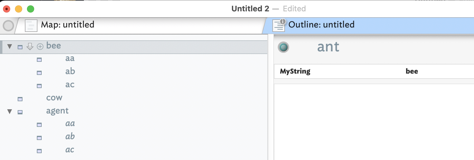

Have you thought of a Display Expression? So, rather than change the actual container title (it’s $Name), you could use a Display Expression to display a label of ‘GoodreadsReviews’, whilst letting the app string with the $Name of DEVONthink.
I’d do it like this, after making the watched maintainer:
  • Add MyString to the Displayed Attributes of the Auto-set Prototype: Imported from DEVONthink prototype.
  • In you new watched DEVONthink folder set MyString to ‘‘GoodreadsReviews’’
  • Set the containers Display Expression to be `$MyString’
I don’t realy use this feature some am not sure of the deeper aspects of this. But, using a Display Expression seems to be a workaround for having a displayed for the container the makes sense to the human user and without having to change its actual $Name title.
Thanks again. The Display Expression is quite nifty, at least for distinguishing between different watched folders. I suspect that the agent query (or at least the inside(…) function) still requires the actual $Name.
This one maybe still needs some mulling over.
Yes, but you can invert the question, by asking what is the container’s (an item’s parent) $DisplayName.
Here, container ‘ant’ has a Display Expression setting a $DisplayName of ‘bee’:
The agent query is:
$DisplayName(parent)=="bee"
but “bee” could be an attribute or variable value.
HTH
