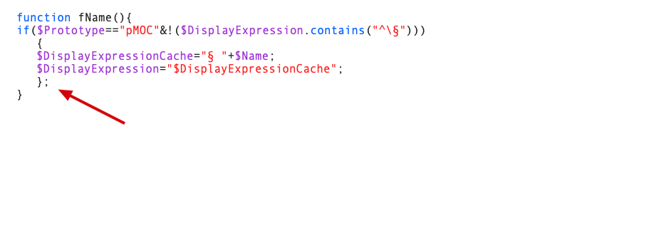

what about nested if statements, like this one…do I need a semicolon
Sorry to be so dense…but I feel this is important.
Tom
The semicolon at which the arrow points — the semicolon following the closing }, is not necessary* but does no harm.
  • I can concoct odd scenarios with complex, nested conditionals where I think the semicolon might have an effect. But you should avoid complex, nested conditionals and such anyway.
