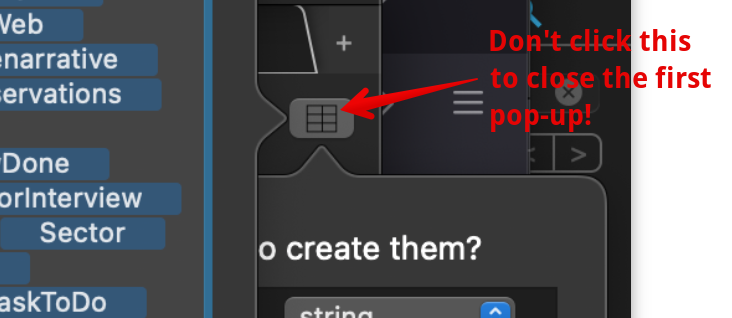

Thanks, Mark! Unfortunately when I do this, the list of DAs overlaps the “do you want to create?” list so that I cannot see all of the options.
Anyone else having this issue. Resizing such windows as I can resize does not change the display of these two pop-ups, ie, resizing doesn’t solve the problem.

Well, that’s odd. Never seen that effect and can’t reproduce it here. No, by accident, I think I found the cause. When you click outside the first pop-up, where do you click? I ask as the only way I can replicate this is if, instead of clicking off the initial pop-over, I click on the pop-over calling button.
I think I see what happens. When you click the open Displayed Attributes pop-over button with the pop-over already open, the current pop-over closes triggering the secondary pop-over. But the click also re-triggers the original pop-over to re-open.
So please try this. Open the pop-over with the undefined Displayed Attributes names. Now click anywhere outside the pop-over except the button used to call the pop-over:
Does that work?
Incidentally, the second pop-up still works, albeit some of it is obscured.

If the above explanation on where to click to closeems complex, image the button to open the Displayed Attributes pop-over is labelled “START”. We could then say: to close the pop-up click anywhere except on a button labelled ‘START’.
OR
(having checked). If, having set up your chosen Displayed Attributes including new attributes, you can press the Escape key (⎋) and the pop-up will close and still open the secondary pop-up. You can now either add the new attributes or click Escape again without making an any changes to leave Displayed Attributes as they were. I’ll admit I find this a bit counter-intuitive as I’d assume the first button press would close the first pop-over without calling the second pop-over as I think of Escape as akin to ‘Cancel’. But, whatever. If it helps, give it a try!

Thanks very much! I had gotten the impression that clicking elsewhere did nothing, and that therefore I HAD to click on the pop-over calling button.
Obviously that was a mistake. I appreciate you taking the time to straighten that out.

Various fixes relating to both issues will appear in the next release.
