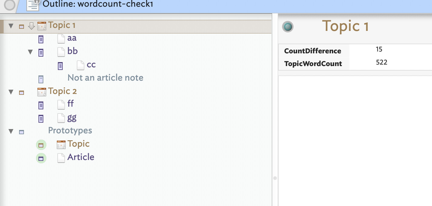

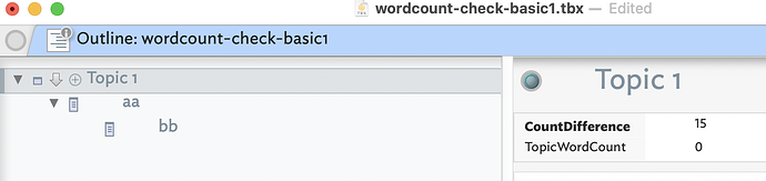

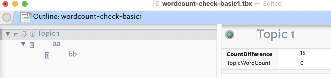

Give the doubt expressed about earlier suggested code (which was tested before posting), I’ve made a quick demo: wordcount-check-basic1.tbx (81.0 KB)
But that’s just the very basics. Now we know from that test the concept works, we can make a more real-world test. Here is a more worked through example was built on the above: wordcount-check1.tbx (97.1 KB) (this appears to have an unexpected glitch, see further posts for a resolution).
In the second demo:
  • The container note now using a prototype ‘Topic’. Its OnAdd sets children to prototype ‘Article’.
    • Why use prototypes? Coding a Rule for one container, no real gain. But, if using 10 or 100 containers/notes, a big gain as all use the same code and inherit from the prototype.
  • The prototype ‘Article’ also uses OnAdd to set new children to prototype ‘Article’.
  • The Topic prototype’e rule now checks for descendants that only of type ‘Article’, and the rule is disabled in the prototype, only running in inheriting notes.
  • The descendants of the test topic container deliberately include a note not using the 'Article prototype. I added a note then removed the OnAdd-assigned prototype before doing any edits to the new note.
  • Each ‘topic’ using container can set its own $CountDifference value via its Displayed Attributes. In the demo to two test topics each use a different value.
  • … and there’s more you can add if you’ve other edge case issues you need to test
The basic rule here could have been texted with 3 notes: a container and one child
& grandchild. The demo has more as i’ve illustrated abstraction int prototypes and included several tests (non-‘Article’ descendants, different countries triggers for different topics, etc…)
We see that no child needs a rule managing word counts as all the work is done via the container’s rule. Also demonstrated is the commended technique of testing a new idea in a minimal test file before adding any changes to your actual working document. This approach has important advantages, especially for those new to action code:
