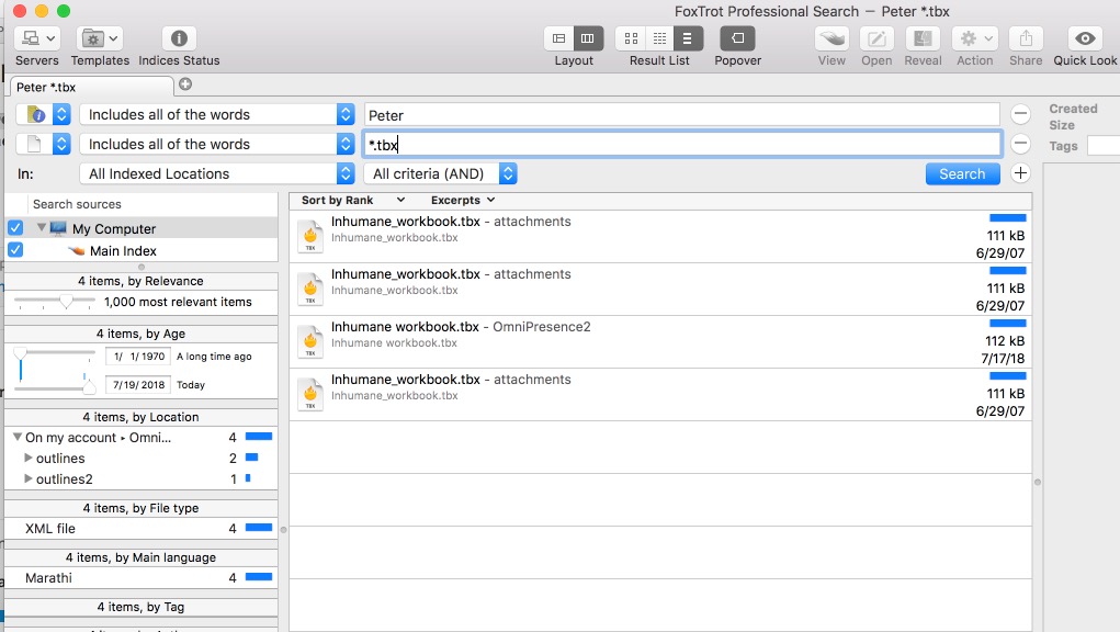

Foxtrot shows content with Omni Outliner, but not with Tinderbox.

Yep. I’m going thru that now – every time FoxTrot builds an index it corrupts it the next day. Piece of junk.
You might try support at CTM. I’ve used FoxTrot Pro for years and years and rarely had a problem. When I’ve had one, I’ve had excellent support. It is a product with a unique feature set. The searching is incredibly fast (much faster than grep) and it has operators for complicated searches on par with DevonThink. There are a few other tools for refining searches. My favorite tool–unique as far as I know–is the ability to preview a PDF with each search term in a different highlight colour. This is useful when you have one high frequency term and one low frequency term–but you need both–because you can find the low frequency hits fast. I use this to manage a large collection of PDFs, many book-length.
FoxTrot depends on a QuickLook importer to read non-standard file types like OmniOutliner, though in this case it just uses the raw data as if it were plaintext. Since, so far as I know, there is no QuickLook importer for Tinderbox this explains the difference between hits for OmniOutliner and Tinderbox in FoxTrot.
Unfortunately, this design makes FoxTrot vulnerable to poorly written Quicklook importers–of which there are many. This can cause crashes or corruption. You can manage which importers are used by launching FoxTrot with cmd-option held down. There is a “blacklist” facility which gives clues about rogue importers too, found in the Manage Indices dialog.

However, Foxtrot doesn’t seem to peer into Tinderbox files. It finds them just fine, but you don’t get a string preview. Is that the Quicklook functionality?
Yeah, I just confirmed QL on Tbx, you actually get preview too (which you don’t get on OmniOutliner, although you do get it on OmniGraffle…c’mon, Omnigroup). I just dropped Jerome a note asking him to get us .tbx support, we’ll see. I think the ideal quicklook for Tbx would be text without the xml tags, rather than a graphical representation. Outline view, in other words.

In relation to Foxtrot it seems I was not right. A recent message on the Foxtrot discussion list indicates that they use “Spotlight metadata importers” to index various files. (I put it in quotes because that is their description.) So it is true they use third party plug-ins, evidently of a different kind to the Quicklook plug-ins. Perhaps one of these Spotlight metadata importers would help.
However, apparently there is a simpler solution according to CTM support. If Tinderbox files were to have a UTI declaring the file as of XML type, then their built-in xml importer would work. (I suppose this explains the OmniOutliner success, since it has an XML UTI.)
There is an immediate solution according to CTM support, using a hidden preference. If one were to enter this command at the terminal, Foxtrot should index Tinderbox files:
defaults write com.ctmdev.foxtrot Aliases -array-add "{type='tbx'; as='xml';}"
I have not tested this yet, but if it works it would be a boon for those who find Foxtrot useful.
