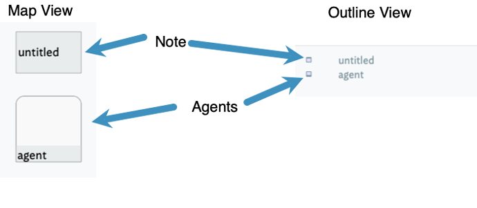

    They had notes there were assigned with my Agent prototype, but just assigning a prototype to a note does not make the note an agent. You must create an agent first and then you can assign a prototype to that agent if you’d like. Question for @mwra and @eastgate, what attributes distinguish an agent from a “normal” note? It does not appear that simply adding an agent query does the trick. Are there attributes that you can tweak to turn a normal note into an agent? My guess is no.

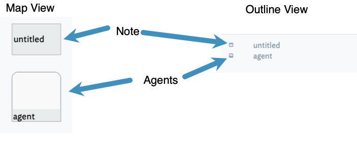

For those interested: it is easy to distinguish a note and agent in Map View, but it the outline view it is a bit more subtle. In Map View, the agent will have rounded upper corners and the name on the bottom. In the Outline View, the note will have the dark line along the top and the agent will have it along the bottom.

Correct. Agents are normally made via the Note menu but action code has a createAgent() action that you might find useful. If using the latter, once the agent exists you then give it a query. Setting a query value is not part of the createAgent() operation.
There is no method to turn a note into an agent or vice-versa, as described here.
Agents have no specific attribute. The normal method to locate agents is to look for items with an $AgentQuery value. Before it is pointed out, it is possible to have an agent with no query or a note with a query value set. However, neither of the latter configurations does anything: the former because the agent doesn’t (yet) know what to match so has no child aliases and the latter because a note cannot function as an agent. It is also possible to have an agent with a valid query but no matches. The latter commonly occurs where an agent has an action that alters an attribute value thus altering the item’s match to the agent query.
