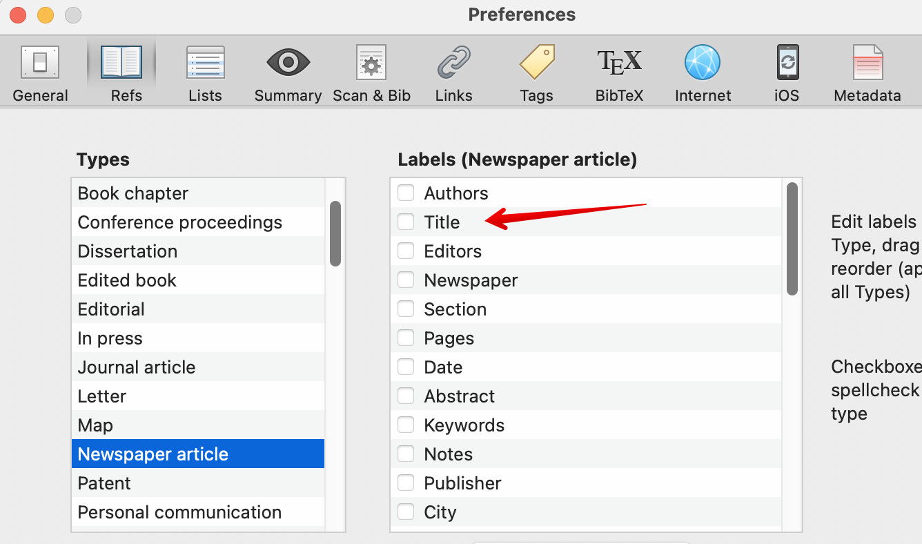

But, I fear you misunderstand the process. In Bookends the ‘Title’ to which you refer is an _on-screen label that can change according to the article type you select (book, book chapter, proceedings, etc. As it happens, I think all reference types in Bookends use the same field & label for the items name/title.
So in Bookends, if the item is of type ‘book chapter’ the underlying Bookends database field that stores the proximate name of the item in the database’s Title field. You can see this in the Bookends preferences:
If the type is a ‘newspaper article’ the headline of the article goes into … the same Title field:
The (Bookends) database’s job is to provide the discrete parts a reference to the formatting manager. When Bookends loads data into a drag operation, it passes some information in RIS format inside which the database Title field is set as the value of the T1 RIS regardless of the source article type. The article’s type is the value of Bookends’s Type and is passed as the RIS TY value.
So the information Tinderbox gets is a title (RIS field T1) which goes in the Tinderbox attribute $ArticleTitle (so essentially the same as Bookends’s behaviour). RIS field TY data is written to the Tinderbox attribute $RefTitle. This happens regardless of the type of reference being passed. So, if the title of a ‘book chapter’ in Bookends is “XYZ”, this will be the $ArticleTitle in Tinderbox.
