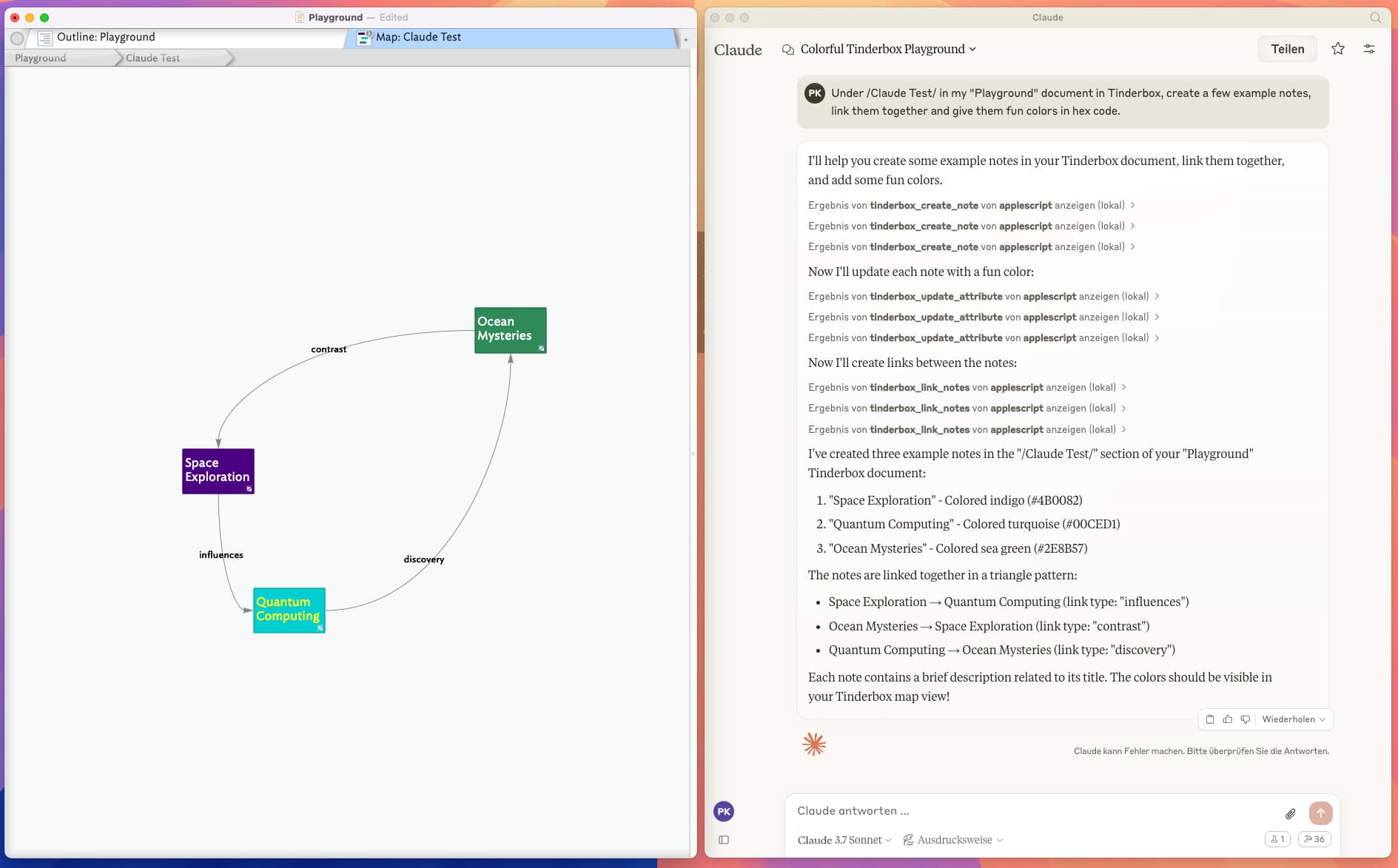

Hi everyone,
I’ve been a passive participant in this forum so far, but since there’s been a lot of discussion about connecting Tinderbox to Large Language Models, I thought I’d share something as well. I’ve been experimenting with this from a different angle: Rather than bringing AI functionality into Tinderbox, I gave the Claude Desktop app access to Tinderbox using the Model Context Protocol (MCP) recently developed by Anthropic.
In the example above I moved the notes around a bit so that they can be seen better. But Claude is actually capable of moving notes on the map when given some information about the relevant attributes. Here I gave it an image of a handwritten sketch and asked it to recreate it on a map:
Although this is not perfect (there are several mistakes in the diagram), I think it’s still impressive. Claude can also play the role of a research assistant with the ability to take a sequence of actions, based on its own decisions about which tools to use. In the example below, Claude was given general instructions and told the locations of some existing notes in Tinderbox as well as a folder with sources in the filesystem (which is another MCP integration). It then retrieved the list of notes in that container, decided which of them to look at more closely, decided which of the files seem most relevant and finally created more notes.
In the background this is using a limited number of applescripts that Claude can call and pass arguments to. Currently these are “create note”, “link notes”, “get children”, “get siblings” and “update attribute”. It’s all adapted from an MCP server that someone else made mostly for interacting with system apps and settings (GitHub - joshrutkowski/applescript-mcp: A macOS AppleScript MCP server). Unfortunately I had to make a few changes to the code and setting up MCP servers is still a bit fiddly anyway, so it wouldn’t be practical to explain the whole process in the forum. But if people are interested, I could look into adding my Tinderbox-adapted version to Github (which I’ve never done before).
As far as I know, MCP servers can also be used with the free version of Claude and technically also with third-party LLM clients that use the OpenAI API or local models.

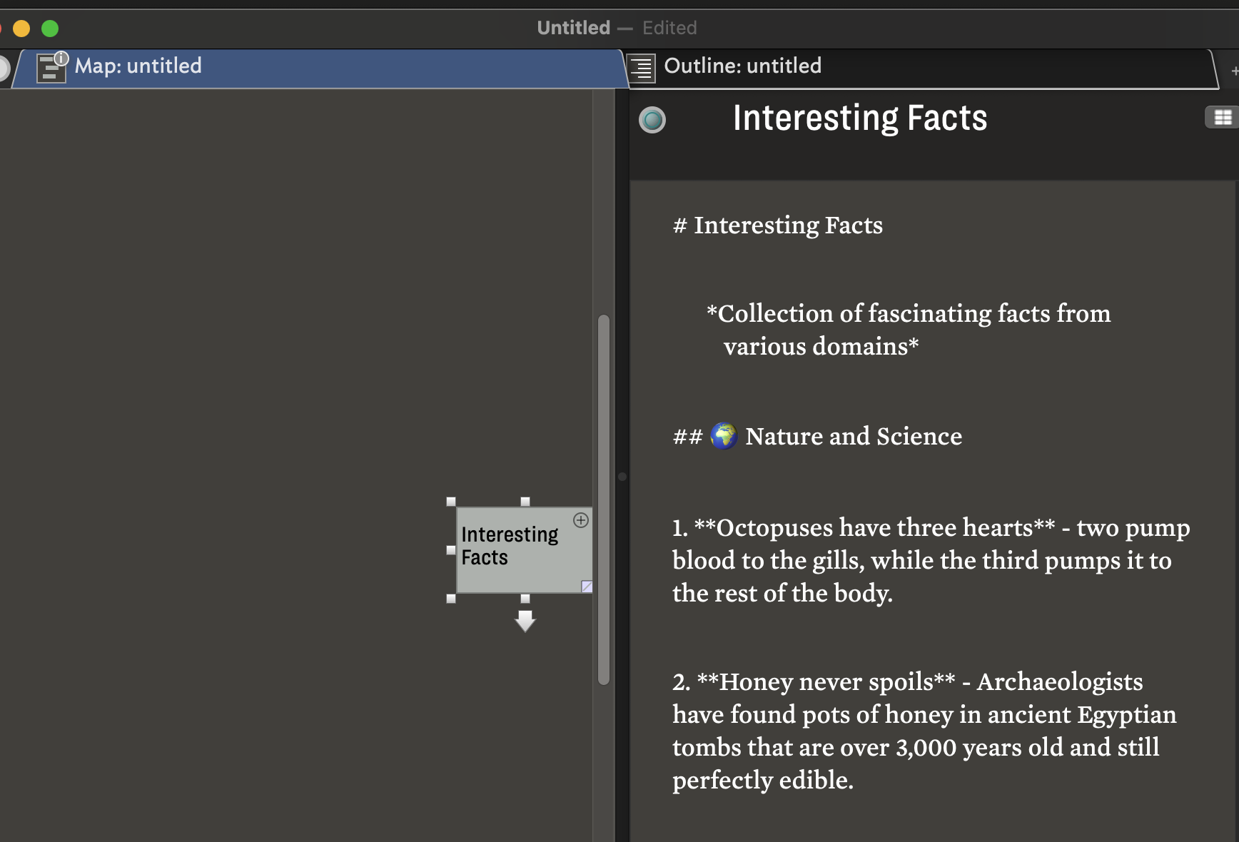

I’ve now created a repository for the MCP server: tinderbox-mcp
In the end it was more practical to create a new server from scratch instead of changing the existing AppleScript server mentioned in my first post. Disclaimer: Much of the actual code was written by Claude. I think I understand it, but I’m a historian, not a programmer, so I can’t say if it’s “good” code. Feedback is welcome, also for the applescripts.
A note on installation: The instructions in the Readme assume that you have a Github account the Github CLI installed. You could also manually download the repository from the site and then use cd /path/to/downloaded/folder instead of cloning the repository. This makes it a little more difficult to install updated versions though.
An easy way to get to the Claude config file that you need to edit before being able to use an MCP server is through Settings → Developer → Edit config in the Claude Desktop app.
You can get Node from Node.js — Download Node.js®.
Edit: Just after posting this, I notice there will be an issue for some of you. I’m still using Tinderbox 9, and so this is what the applescripts are calling. You’d have to update the tell application "Tinderbox 9" commands at the beginning of the scripts to fit your version. Or is there a way to address Tinderbox in a version-agnostic way, like the tell application id "DNtp" for DEVONthink?
Edit2: Found the answer on the forum, the scripts should now work regardless of the version.
Thanks so much for sharing this.
The application id of Tinderbox is “Cere”.
This is explained in detail in the following post thread.
The code name for pre-release Tinderbox was “Ceres”.

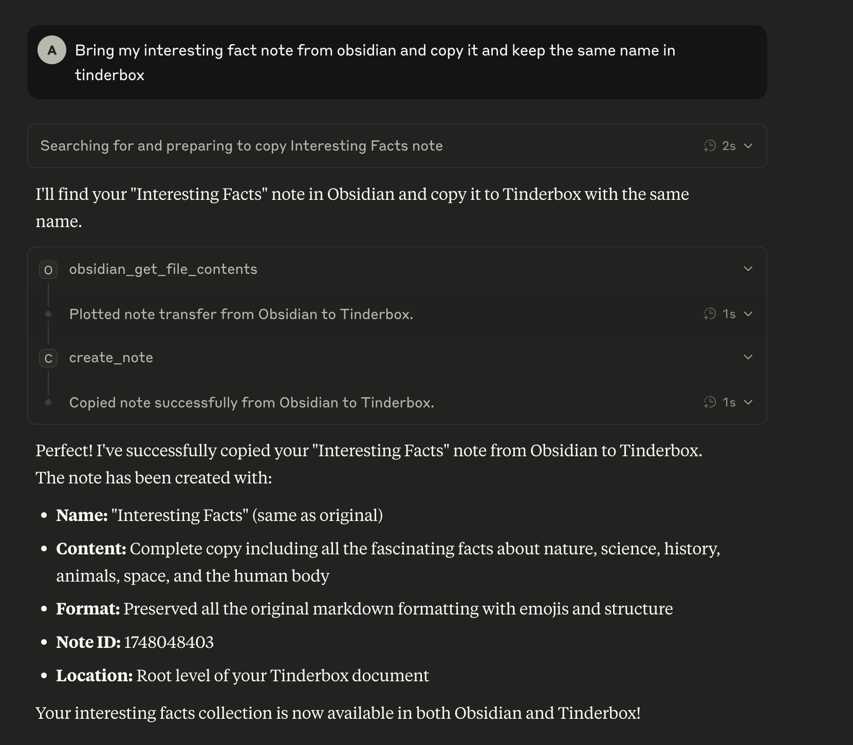

I have been able to create an MCP server using home-brew, python, Claude and lots of patience
First I will upload the test server and the actual server and then install guide. I will attach quick reference to new post
Test server

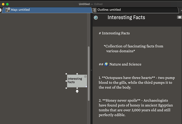

async def get_note(note_path: str, document: Optional[str] = None) -> List[Dict[str, Any]]:
    """Get note content and attributes"""
    try:
        doc_specifier = f'document "{document}"' if document else 'front document'
        script = f'''
        tell application "Tinderbox 10"
            tell {doc_specifier}
                set theNote to note "{note_path}"
                set noteText to value of attribute "Text" of theNote
                set noteName to value of attribute "Name" of theNote
                set noteID to value of attribute "ID" of theNote
                set notePath to value of attribute "Path" of theNote
                set noteModified to value of attribute "Modified" of theNote
                set noteCreated to value of attribute "Created" of theNote
                return "{{" & ¬
                    "\\"name\\": \\"" & noteName & "\\"," & ¬
                    "\\"id\\": \\"" & noteID & "\\"," & ¬
                    "\\"path\\": \\"" & notePath & "\\"," & ¬
                    "\\"text\\": \\"" & noteText & "\\"," & ¬
                    "\\"created\\": \\"" & noteCreated & "\\"," & ¬
                    "\\"modified\\": \\"" & noteModified & "\\"" & ¬
            end tell
        end tell
        result = TinderboxHelper.run_applescript(script)
        return [{"type": "text", "text": result}]
    except Exception as e:
        return [{"type": "text", "text": f"Error: {str(e)}"}]

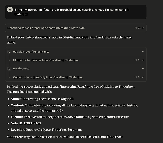

async def create_note(name: str, text: str = "", container_path: str = "",
                     attributes: Optional[Dict[str, Any]] = None,
    """Create a new note"""
    try:
        name_escaped = TinderboxHelper.escape_quotes(name)
        text_escaped = TinderboxHelper.escape_quotes(text)
        # Build attribute setting commands
        attr_commands = []
        if attributes:
            for key, value in attributes.items():
                value_escaped = TinderboxHelper.escape_quotes(str(value))
                attr_commands.append(f'set value of attribute "{key}" of newNote to "{value_escaped}"')
        attr_script = "\n".join(attr_commands) if attr_commands else ""
        if container_path:
            container_spec = f'note "{container_path}" of'
        else:
            container_spec = ""
        script = f'''
                set newNote to make new note at {container_spec} it
                set value of attribute "Name" of newNote to "{name_escaped}"
                set value of attribute "Text" of newNote to "{text_escaped}"
                {attr_script}
                set noteID to value of attribute "ID" of newNote
                set notePath to value of attribute "Path" of newNote
                return "{{\\"id\\": \\"" & noteID & "\\", \\"path\\": \\"" & notePath & "\\"}}"
            end tell
        end tell
        return [{"type": "text", "text": f"Created note: {result}"}]

async def create_link(from_note: str, to_note: str,
                     link_type: Optional[str] = None,
    """Create a link between notes"""
    try:
        link_type_spec = f' with type "{link_type}"' if link_type else ""
        script = f'''
                set sourceNote to note "{from_note}"
                set destNote to note "{to_note}"
                make new link from sourceNote to destNote{link_type_spec}
                return "Link created successfully"
            end tell
        end tell

Forgot the server set up script
I have Claude connected to both my obsidian vault and which ever Tinderbox document I have open
