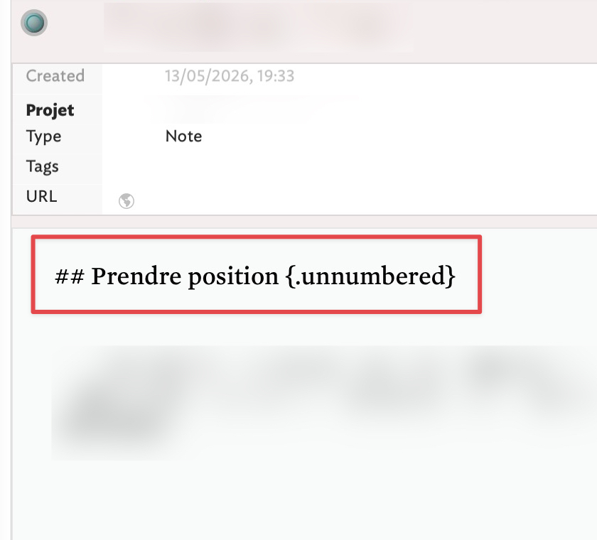

Furthermore, I’d need each note of level 2 or 3 to be accompanied by the mark {.unnumbered}. The reason is this: when I compile my notes in my Markdown editor, it’s easier to remove this mark if I don’t need it than to add it to each heading if I need my notes to be numbered.

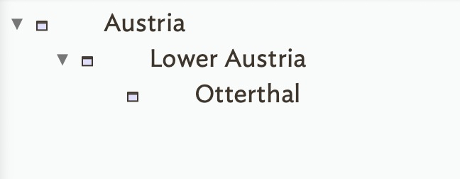

Just to clarify: you have an outline in a Tinderbox container. You’d like to export this outline to Markdown, writing the names as headings. We don’t use the text of the note—or, at least, we don’t use the text yet. Is this right so far?
If so, suppose I walk in and choose some arbitrary note in your outline. Say “Otterthal”. How do we know whether Otterthal gets #, ##, or ###?
If I have three notes: Austria, Lower Austria, and Otterthal, I would arrange my notes in a « geographical » order, so in the following way:
The Lower Austria container will be of level 2 and the Otterthal note of level 3.

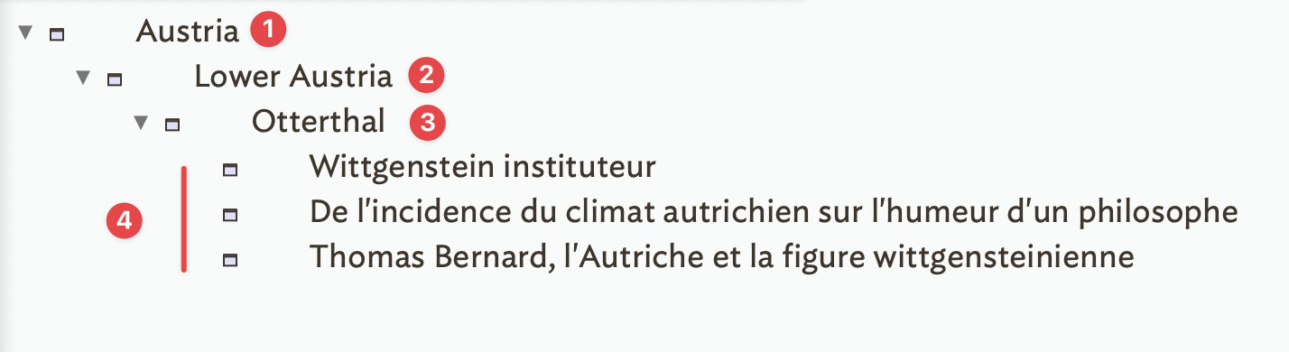

Now, if I were to research Wittgenstein’s life during his time as a schoolteacher in Otterthal, I would need some material: an article by a French philosopher and a few reflections from my reading. This would make three notes arranged as follows:
I did not pay enough attention to your question : I don’t just need to export the plan, I also need the text of the notes.

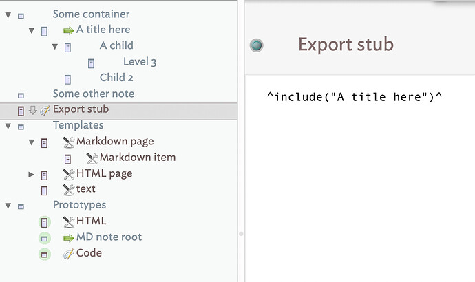

The easiest way to do this might be to have four templates. The second level template might be
## ^value(Name) {.unnumbered}
^text
The process is the same as the default HTMLO export template, in terms of process, we just need different code (Markdown not HTML for the headings. For the text of the notes, you just set up to use Markdown not HTML for ^text^.
So:
  • the exporting container uses a level 1 heading, and then H2 for child etc. (HTML/CSS generally only allows for 6 levels of heading
  • a note’s title ($Name) exports as that sections heading in Markdown form
  • a notes’s text ($Text) is included in Markdown form
  • all notes recursively include their descendants
So:

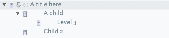

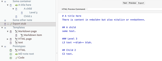

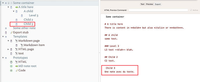

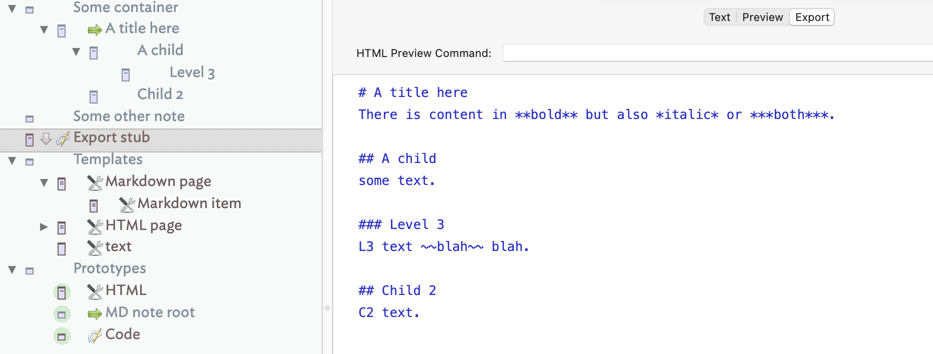

gives a single .md file with content:
# A title here
There is content in **bold** but also *italic* or ***both***.

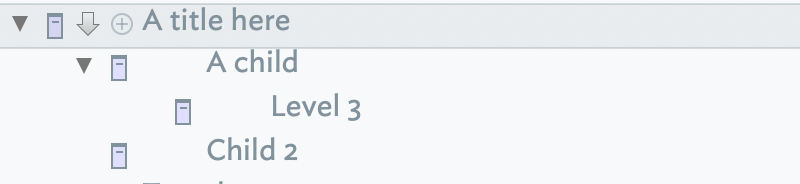

## A child
some text.
### Level 3
L3 text ~~blah~~ blah.
## Child 2
C2 text.

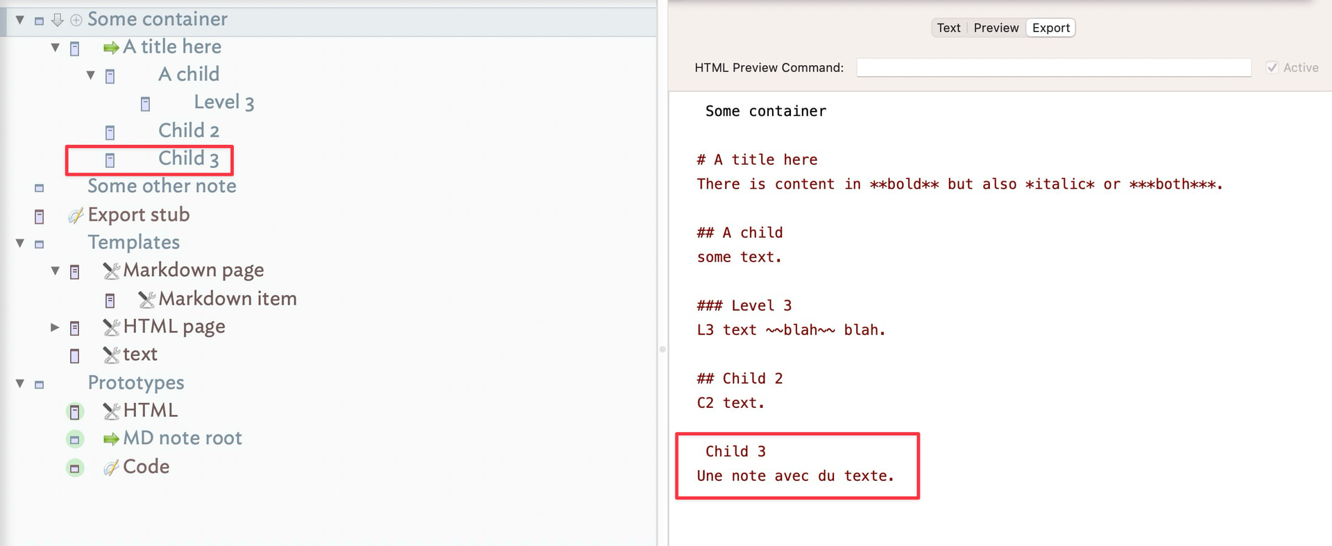

Demo: md-only-export1.tbx (86.1 KB)
  • The templates (‘Markdown page’ and ‘Markdown page item’) were created by modifying the built-in ‘HTML page’ template. A copy of the latter templates is in the demo for you to compare
  • The $TextMarkdown attribute used by the templates in place of ^text^ needs v11.7.0 or later.
  • The heading level Markdown will only be correct if the exported container is at document toot level (where $OutlineDepth is 1). You can make that more flexible but I’ve not time to write all the extra code.
So some things to note but this does what was described as being needed. note there is different between notes whose $Text is written in Markdown but which export as HTML (or MD) but to write in styled text and export Markdown code you beed the new $TextMarkdown attribute.

The md-only-export1 file works perfectly, but when I copy and paste the Templates and Prototypes section and create my own notes, it no longer works. I fell like I’m missing something even when I try to reproduce the file you provided. I have the latest version of Tinderbox. I would like to understand what is happening so that I can then create similar files myself.

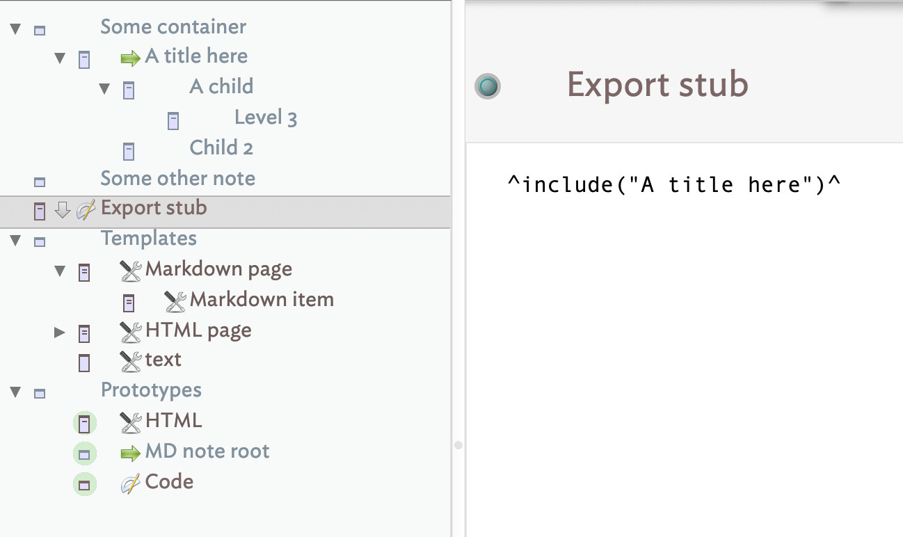

One big convenience is to let all Level 2 notes share a prototype. That prototype (a) sets the template for the notes, and (b) has an OnAdd action that assign the Level 3 prototype to new children

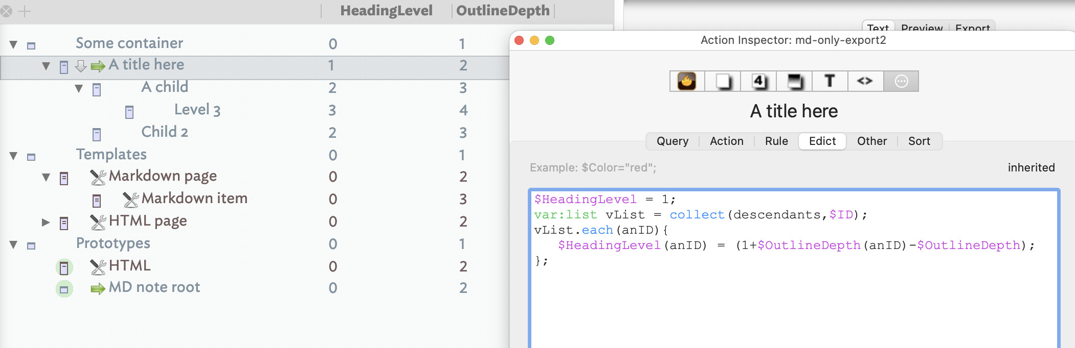

Earlier I noted the heading logic depends on the ‘root’ container making the MD file being at outline root. But what it is isn’t. We can solve that:
The displayed columns in the Outline are simply there to show the results of the calculated heading level.
Here, I use an Edict for the code but you could use a Rule, or even a stamp if you prefer. The method adds a prototype called ‘MD note root’, feel free to give it a different name but remember. Note the edict is disabled in the prototype. The code also uses a user Number-type attribute to store the calculated heading level for use by now revised Markdown export templates ($HeadingLevel replaces use of $OutlineDepth). If $HeadingLevel gets set for a non-exporting note in the descendants does no harm and is easier than filtering for such an occasional occurrence.
Here is the updated demo, versioned via a ‘Save As’:
md-only-export2.tbx (88.2 KB)
I’d meant to do this for the original answer but today got busy on me.

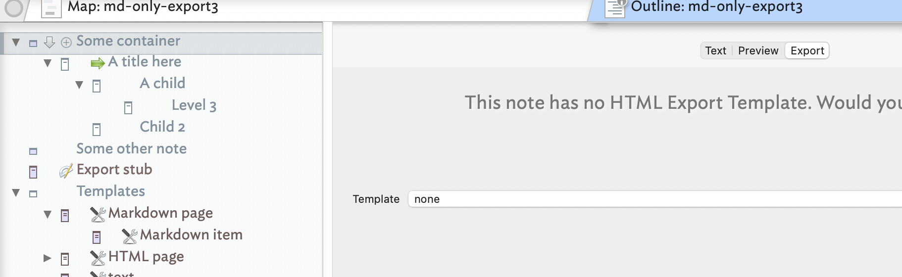

Building on that, one other tweak. When the above example gets exported it goes to where it would export if the whole doc were exported, i.e. nested under several folders. Wouldn’t it be useful to have the content where needed but export it as if at root, so no enclosing unwanted folders? We can…
We add a a new root level note, which is now what we actually export. We give it the built-in ‘Code’ prototype so quotes used in export code in its $Text aren’t messed up. We add a new template ‘text’ whose only code is ^text^. Then, as shown above, we simply include the content from our actual Markdown report buried further into the outline using an ^include()^ call. The result:
So, as before but now our report is exported to the root of where the document exports. A small tweak, but a bit better fit & finish. I’ve TBX with 20-odd such reports exported at root but using content from elsewhere in the TBX.
Demo (versioned again): md-only-export3.tbx (93.2 KB)

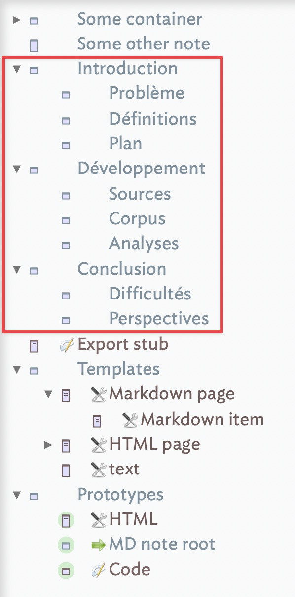

Thanks for your precious help and, please, excuse me if my questions give the impression that I am the kind of student who does not listen to what is said to him and to whom things must be tirelessly repeated which, over the years, should be acquired, but when I try to reproduce the above procedure myself and add a note, it is not numbered and when I add a container to the container titled Some container, I am unable to export the entire document to markdown.
The document model I am thinking of has a very simple structure: like any research article, it has a level 1 Introduction, with level 2 or 3 sub-sections, as well as a level 1 Development, with level 2 or 3 sub-sections and, finally, a level 1 Conclusion with level 2 or 3 sub-sections.
My question is: how do I configure — what code should I use — my document so that I can export my entire file, from the introduction to the conclusion?

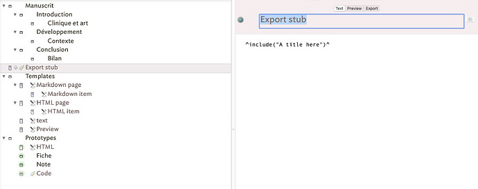

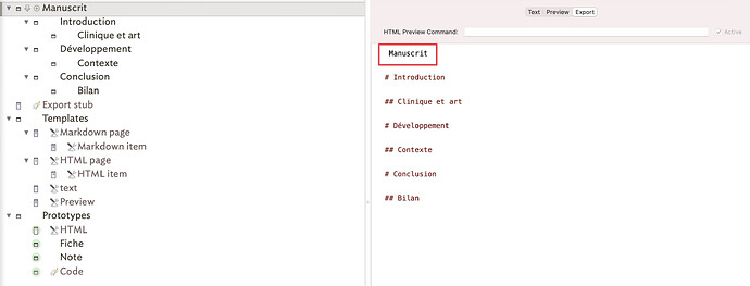

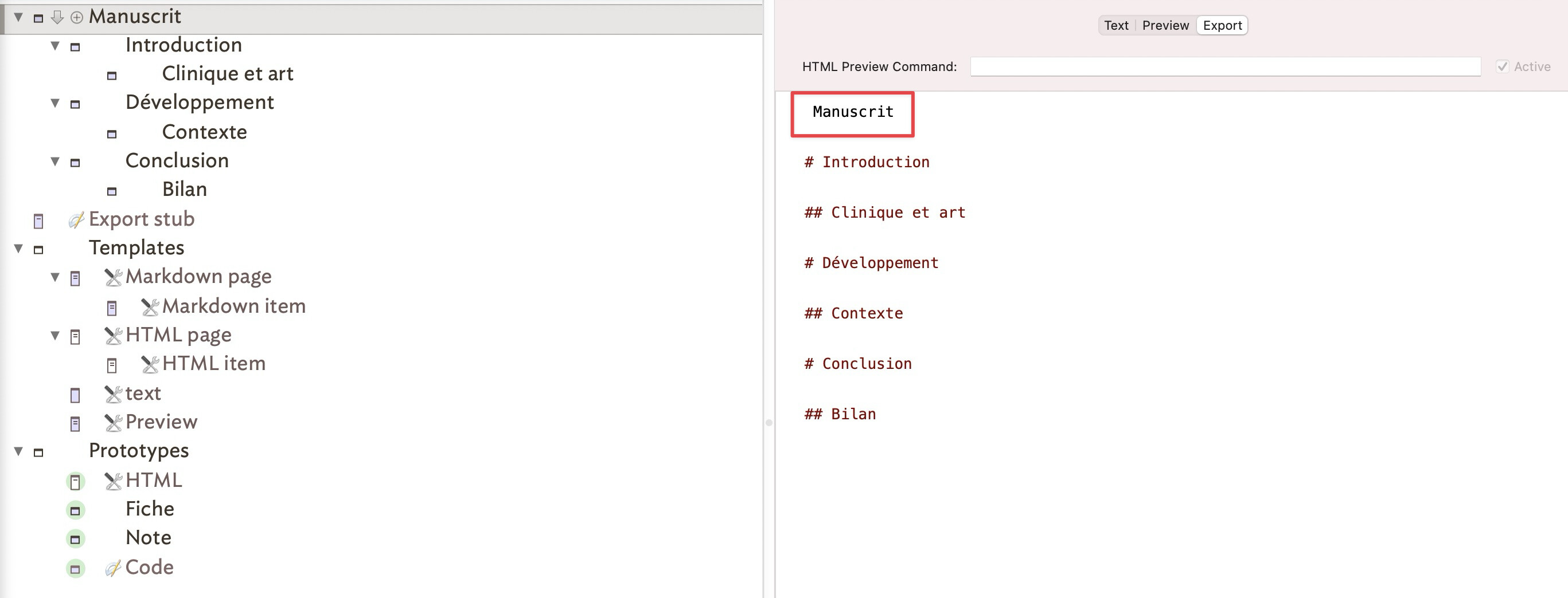

I’m almost there, but no matter how hard I try to understand and review all the elements of the inspector, I think I am clearly missing one element: as you can see on the screenshots below, the container name — Manuscrit — appears in the export section even though I don’t want it, and the section titled “export stub” does not show the container’s contents.

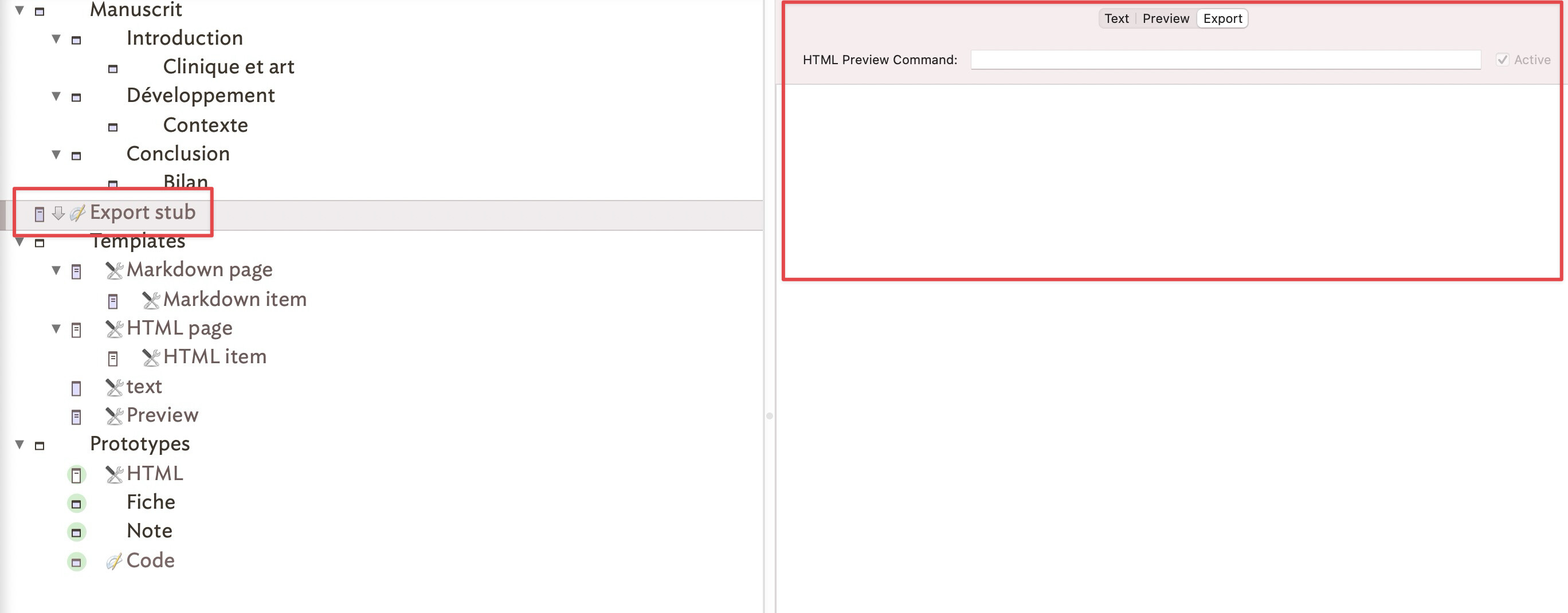

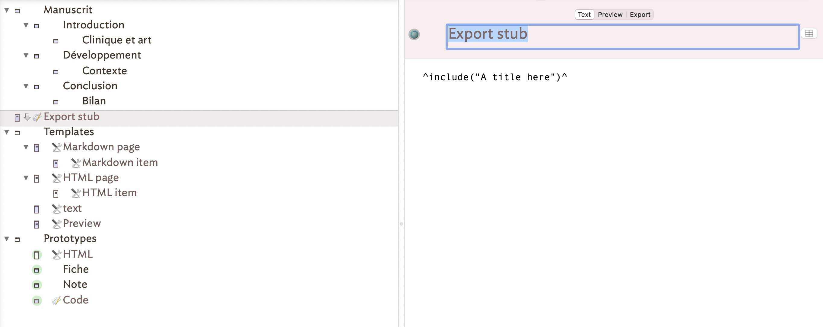

We need a bit more information. What is the $Text of your "Export stub’ note and what template is set? Is your ‘Fiche’ a copy of my “MD note root”? It’s my hunch but I notice the badge has changed so perhaps you made a new note prototype based on mine but didn’t copy all the customisations. The badge itself isn’t important, it is just useful when designing de-bugging to help give you a tell-back that you have set the right information.
I assume, thought is not stated, that you want ‘Introduction’ as the root container for export. in my demo, the equivalent (unwanted) container has no template set:
So I’m confused by your changes, given only a screen grab to work off . Can you shared the test document you show above. It’s probably much easier to look at that and see what isn’t working - though we also need a clear statement of what note(s) we are exporting (I think ‘Information’ and all under it) and from Where (I think via Export stub).
