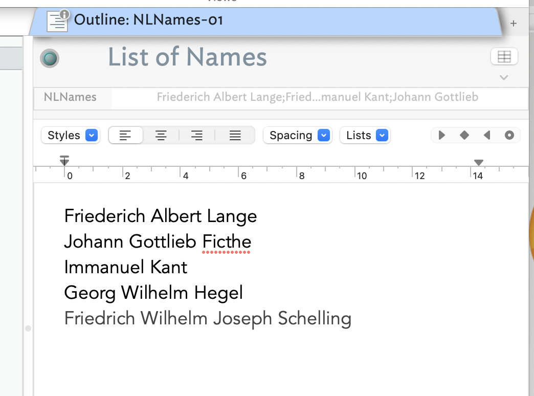

My example is artificial, however I do have a very large file which has a very long list of values populated in NLNames. It is quite ‘jammed full’ and when I look at the field the ‘…’ show that there is understandable truncation in the field. Naively, I had supposed that, while it is a ‘read-only’ attribute, I would be able to get a quick list of it’s contexts via the pull-down arrow to the right.

In fiddling with this this morning I have also noticed that ‘sometimes’ there is a hover available on NLNames and ReadableNames which shows the full content … but this is unpredictable. Once or twice the ‘pulldown’ for ReadableNames was all populated with all values checkmarked as I would expect.

I hear you. Have you considered setting the # lines setting for $NLNames to a higher values?
See System Inspector, and see the section on Lines. Note that you can have between 1 (default0 and 7 lines for String/List/Set/Dictionary (only) type attributes in Displayed Attributes.
