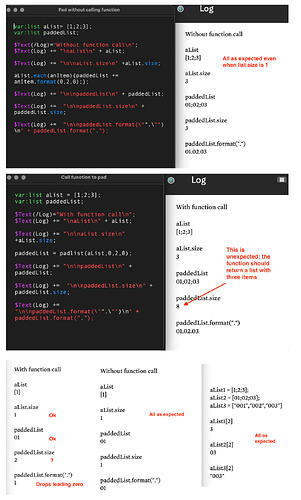

I thought I had this going well until I ran across the problem illustrated in the attached tbx.
Test padlist.tbx (133.1 KB)
This is my padding function:
function padlist(aList:list,decimals,width,padchar:string){
	// pad section numbers for better sorting
    var:list result;
    aList.each(anItem){
        result += anItem.format(decimals, width, padchar);
    return result;
It works as expected when the list has more than one item. But when the note is top-level, i.e. the list of sibling orders has only one item, the leading 0 is dropped. Judging by .size, in all cases the function seems to return a string rather than a list.
Similar code not placed in a function gives the desired results, i.e. it does not drop the leading 0(s) when there is only one item, and list.size is as I would expect.
In the test tbx, I have two stamps, one calling the function and one not. The output goes to the text of the Log note.
I directly edit the list in each stamp to test for one item only.
What am I doing wrong in the function? Or is this an anomaly?
(Unrelated but discovered along the way: list.slice() perhaps deserves an entry in aTbRef if it is not already there-I couldn’t find it and for a while assumed Tinderbox didn’t have it.)
I may be wrong, but I suspect the problem is that, despite the format() operation, Tinderbox thinks that you are constructing a list of numbers and dropping the leading zeros.
That is what I suspected at first. But after flailing around I don’t think so. Here’s my inexpert reasoning.
When the list has more than one item, leading “zeros” are retained with code run directly in the stamp. They’re also retained when calling the function. Everything is fine.
But when the list has only one item (not infrequent with section numbers) the leading zero is dropped when calling the function. But not when similar code is run directly in a stamp.
There seems to be a problem with an edge case–when a list has only one item.
And another puzzle: even if Tinderbox did think I was constructing a list of numbers, why would it report the size of the constructed list as the length of a string, rather than as the number of items in the list, e.g,. [01;02].size as 5 rather than 2?
As demonstrated in the test file, this only happens when calling the function. Code run directly in the stamp reports the size of the constructed list as 2.
I’ve come up with inelegant workarounds. But I am puzzled by this.

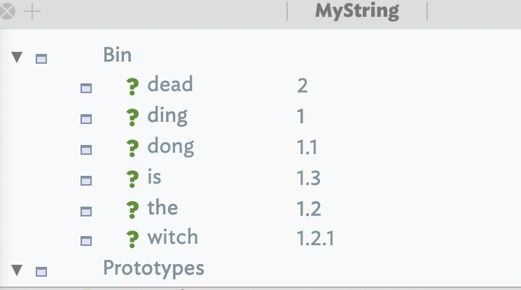

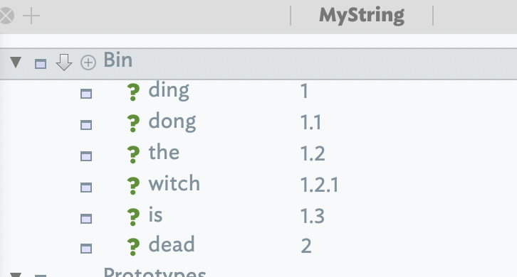

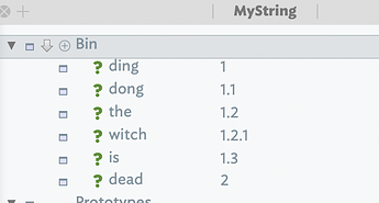

FWIW, this container, sorted on $Name, gets the order right:
So, maybe, we’re overthinking this. Save the section number to $MyString (or other user string attribute) :
Now sort the container on $MyString and:
Another factor. It is highly unlikely, unless working in a single map, that the section numbering will not follow outline order. So, you could collect() the $IDs of all the notes with a section number, then sort that list if items based on their $OutlineOrder.
Of course this may be unsuitable due to additional contingent factors not stated in the original.description.

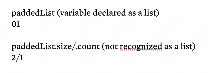

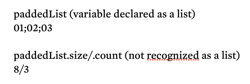

So I still think either my function is awry or Tinderbox is doing something that it shouldn’t, or both.

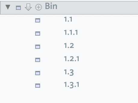

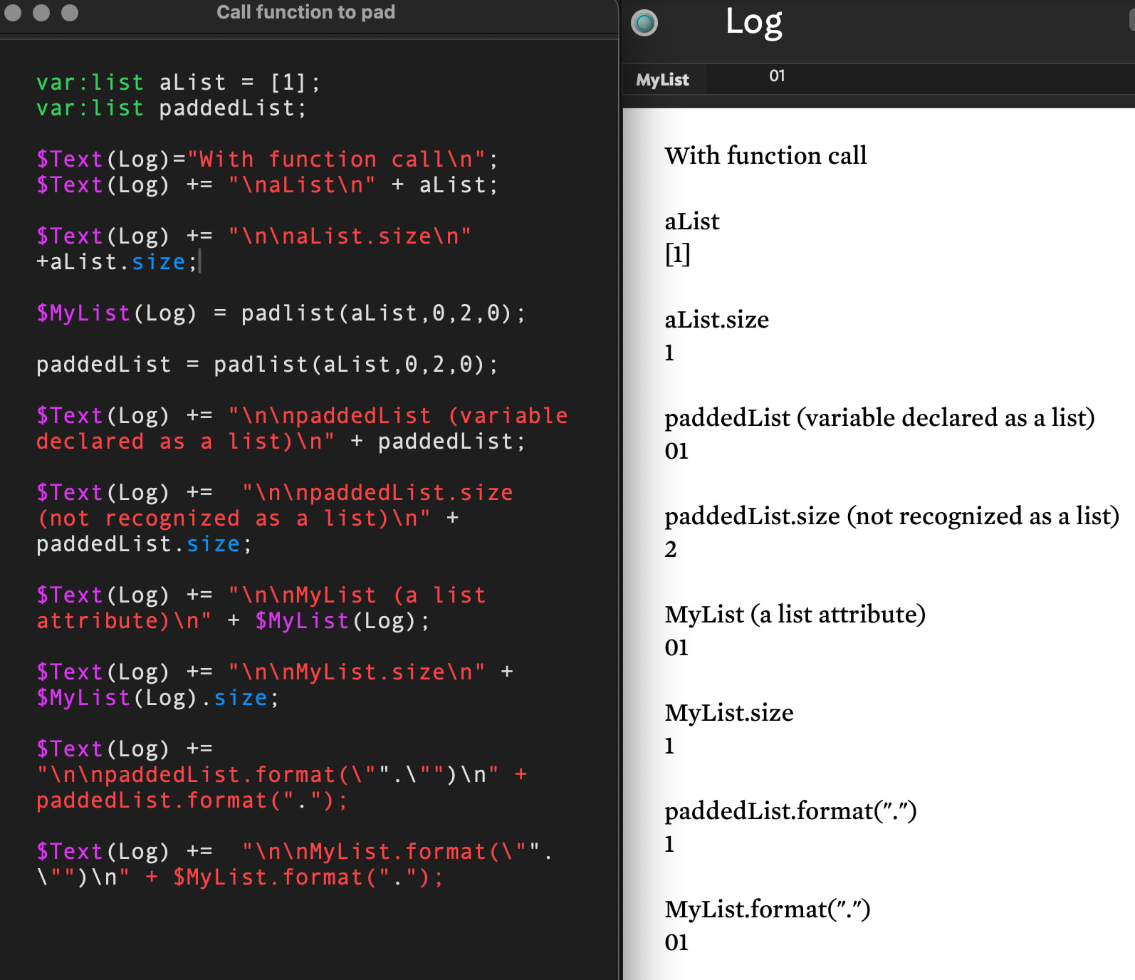

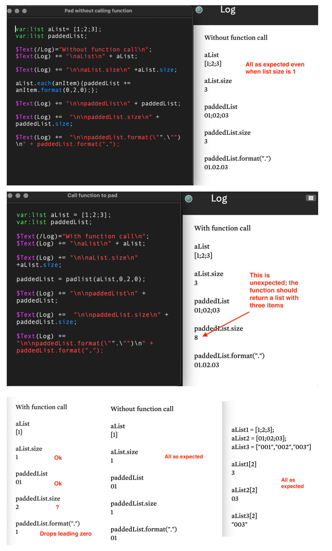

For illustration see the following screenshots generated by this successor to the first test file upthread. Test padlist 2.tbx (141.4 KB)
It would be great if another look could be given to this. I just edit the list in the relevant stamp and look at Log.

But note that in my example on the receiving end I have:
var:list paddedList;
paddedList = padlist(aList,0,2,0);
I originally assumed that a typed variable on the receiving end meant Tinderbox would recognize what is returned from the function as a list. At least in my tests, it does not.
But when a list attribute is on the receiving end, e.g.,
$MyList = padlist(aList,0,2,0);
Tinderbox does recognize what is returned from the function as a list, and I get the results I expected, even with a one-item list.
See screenshot above, or

One oddity spotted:
function padlist(aList:list,decimals,width,padchar:string){...
Note the explicit typing of padchar:string. So we expect argument #4 to be a string. But in tests we see it passed as a number:
when surely the expectation is:
paddedList = padlist(aList,0,2,"0";
Otherwise we’re now forcing Tinderbox to guess our intent and it may be this is part of the seeming edge-case fail. Regardless, on the principle garbage-in/garbage-out, if we stipulate a type for an argument we should provide a literal or typed-value of the stipulated type. Testing it makes no difference—Tinderbox guessed correctly our intent.

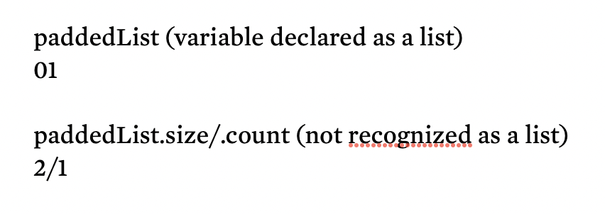

Testing with ‘Test padlist 4.tbx’ I note, whilst Tinderbox guess correctly with the above, I can see there is a difference between the behaviour of .size and count. We see .size gives the character count of the list as string, but .count the number of list items. Using a slightly edited stamp, for a list:
for a single item list
I note my docs show both list.size (added in v5.7.0) and list.count (added in v6.4.0) as reporting the number of list items. Checking in the v5 ‘Release notes.tbx’ and the v6+ ‘Notes.tbx’ from which aTbref builds out, I see no reference of a disparity.
I’m not sure what is happening here.

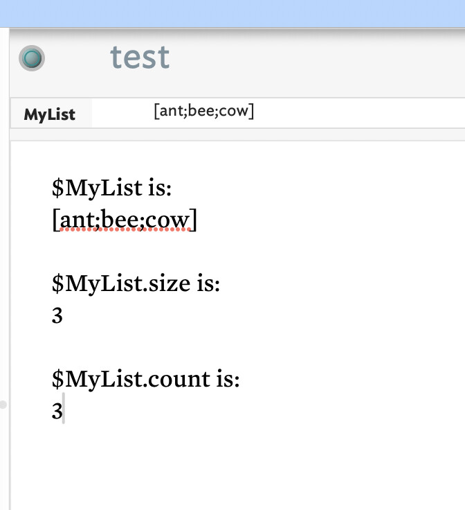

I find this “ducktype” business conveniently forgiving. I still see a perhaps isolated problem when assigning the returned value to a list-typed variable (as opposed to a list attribute). To be sure Tinderbox understands the intent, for now an attribute seems to be the way to go.
That sounds like an error. A minimal example would be a big help here.

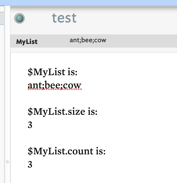

Edict to make the above:
$MyList = "ant;bee;cow";
$Text=;
$Text+="$MyList is:\n"+$MyList;
$Text+="\n\n$MyList.size is:\n"+$MyList.size;
$Text+="\n\n$MyList.count is:\n"+$MyList.count;
Initially, I used the new list syntax of a [] enclosure, i.e.
$MyList = [ant;bee;cow];
which gave this:
Note the square braces in the Displayed Attributes and in the $Text. I think the Displayed Attributes & Get Info tables should use a single consistent display metaphor, either which not enclosure or with the brackets or have unambiguous documentation of the differences and their implication for the user.
