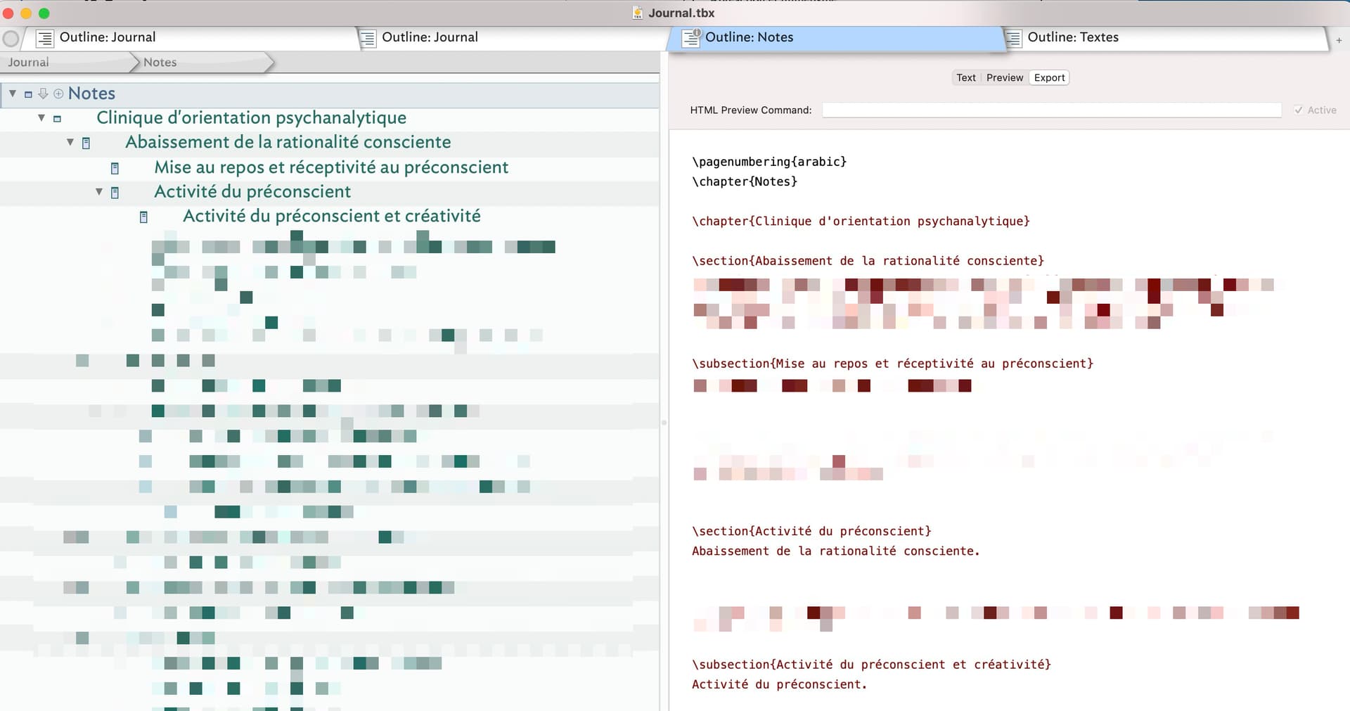

Mark, I’d like to thank you for the file you’ve developed. As WAKAMATSU wrote, it will allow me to export my notes to Texifier, compile them, and then refine my work from the PDF. It might seem insignificant, but as you’re familiar with LaTeX, you know from experience that a PDF generated from a LaTeX file has the appearance of a “finished product”, whether it’s an article or a book. And that’s exactly what I need. I thought I could work directly with Mellel, which is also an excellent tool, but LaTeX offers unparalleled formatting possibilities. I’ll give it some time, and once I’ve become more familiar with this new tool, I’ll provide you with a detailed review.

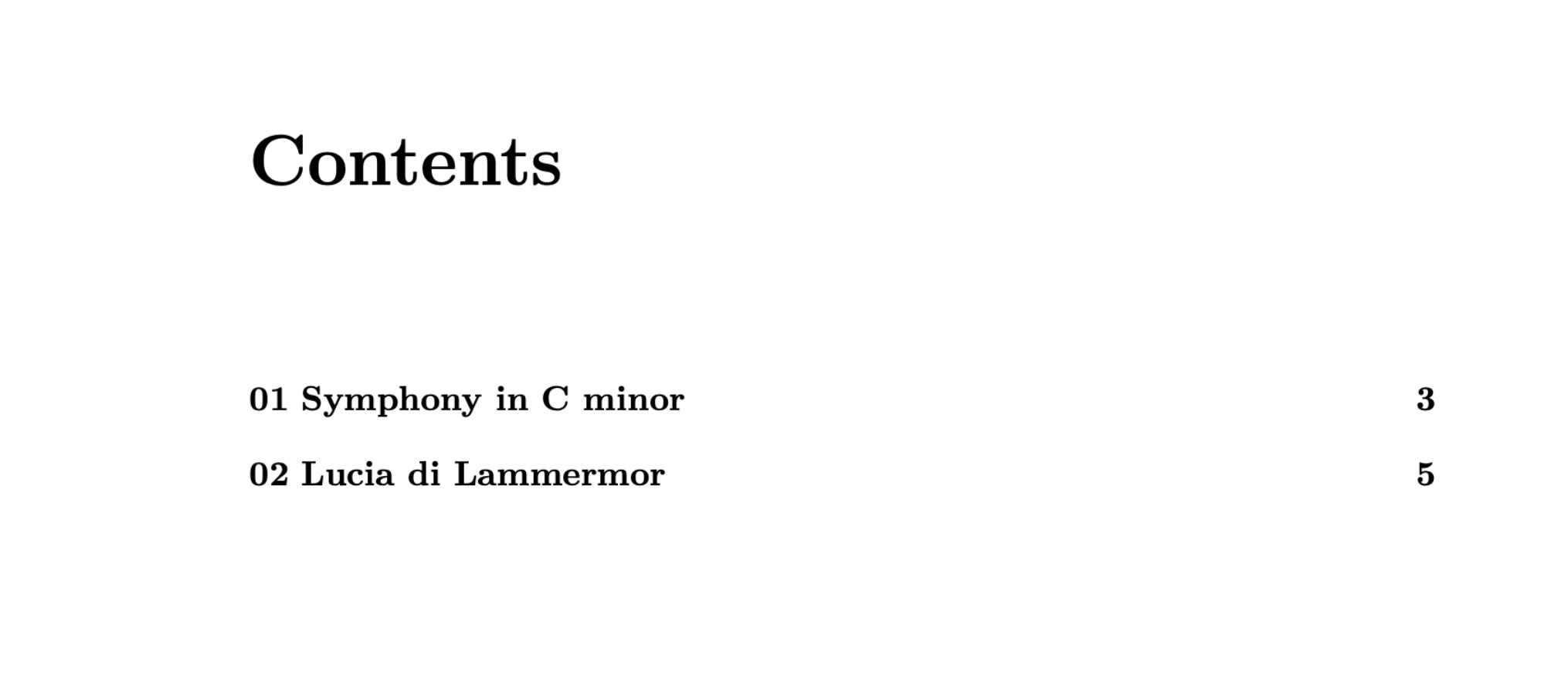

The purpose is to make the specified score number and TOC number the same.
Thanks to your help, I was able to achieve 90% of the look I wanted! !
In the literature I have, the music scores are serially numbered.
This unique numbering is used as is to refer to the score.
Aiming to match all notes and sheet music in Tinderbox10 to PDF
When exporting, the TOC number of your code and the number of the reference score will be different by one.
The problem is that the document placed at the beginning of
LaTeX-multi-note-export.tbx is recognized as one of the sections
and given the first number 1.

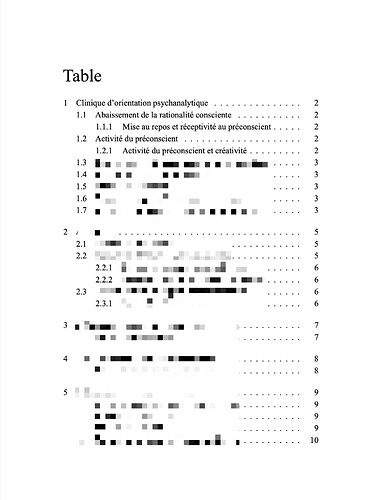

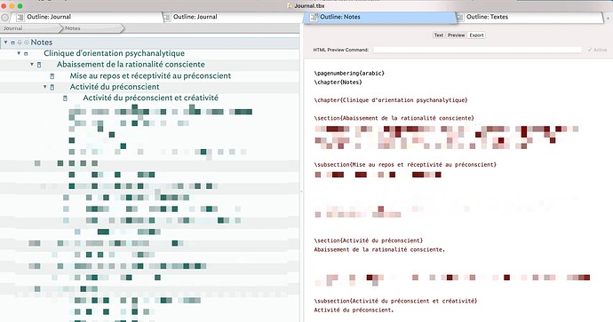

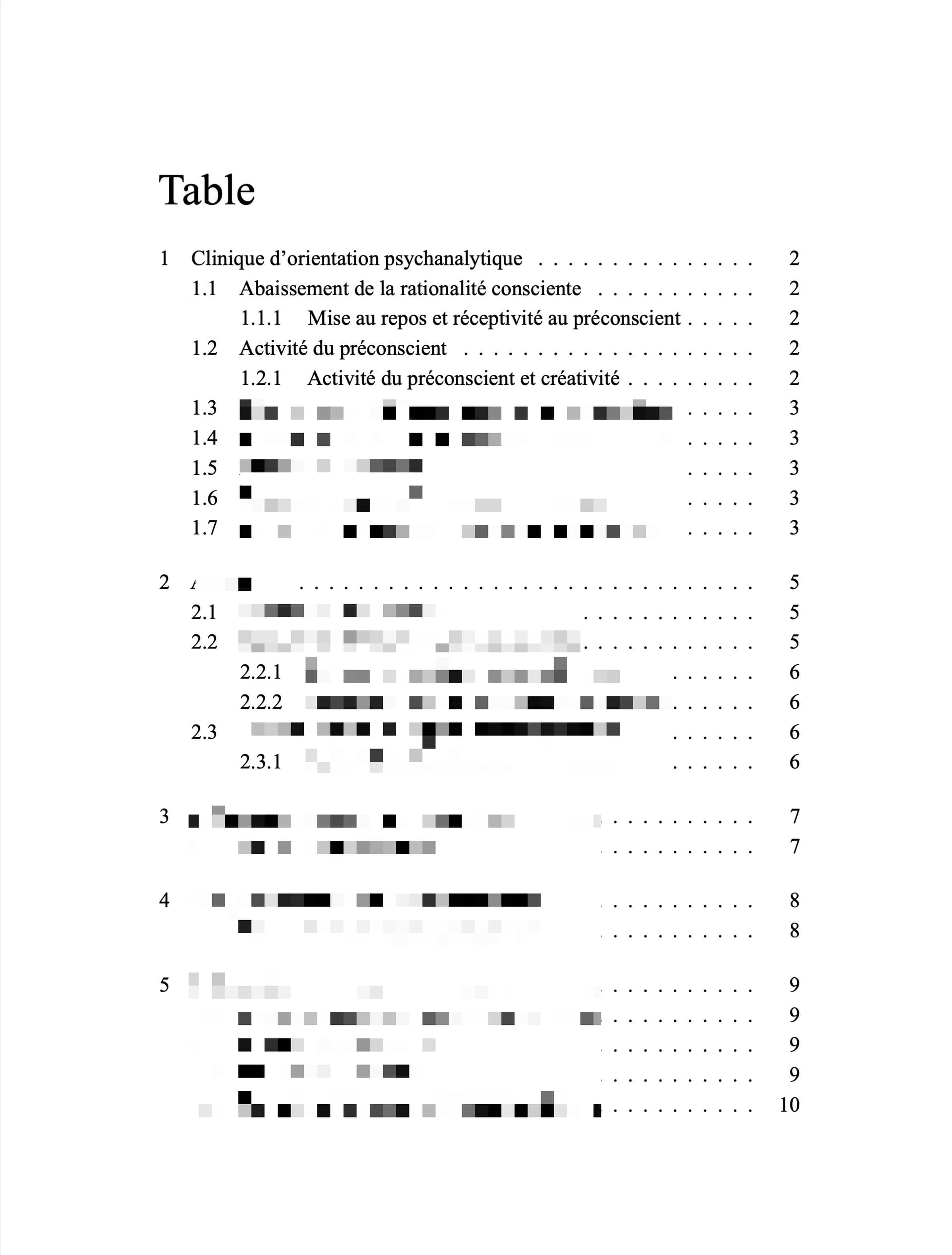

I hope you can understand from the attached image.
The contents of the four attachments are
[1-originalLaTeX document PDF.tiff]
Using the LaTeX document you provided
[2-LaTeX Document.txt]
The slightly modified LaTeX document used this time
[3-LaTeX.tbx.tiff]
Part of the tbx notebook used this time
[4-LaTeX.tbxPDF.tiff]
Export 3 tbx using 2 LaTeX document
PDF image compiled with texstudio-4.9.1-osx-m1.app
Yours, WAKAMATSU
