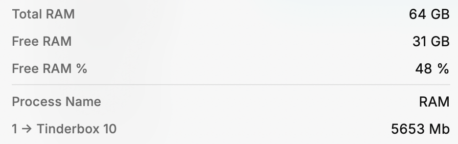

And here is my system data while Tinderbox is working this explode:
Okay, after 35 minutes explode time Tinderbox uses about 5 GB RAM (still no exploded note):
